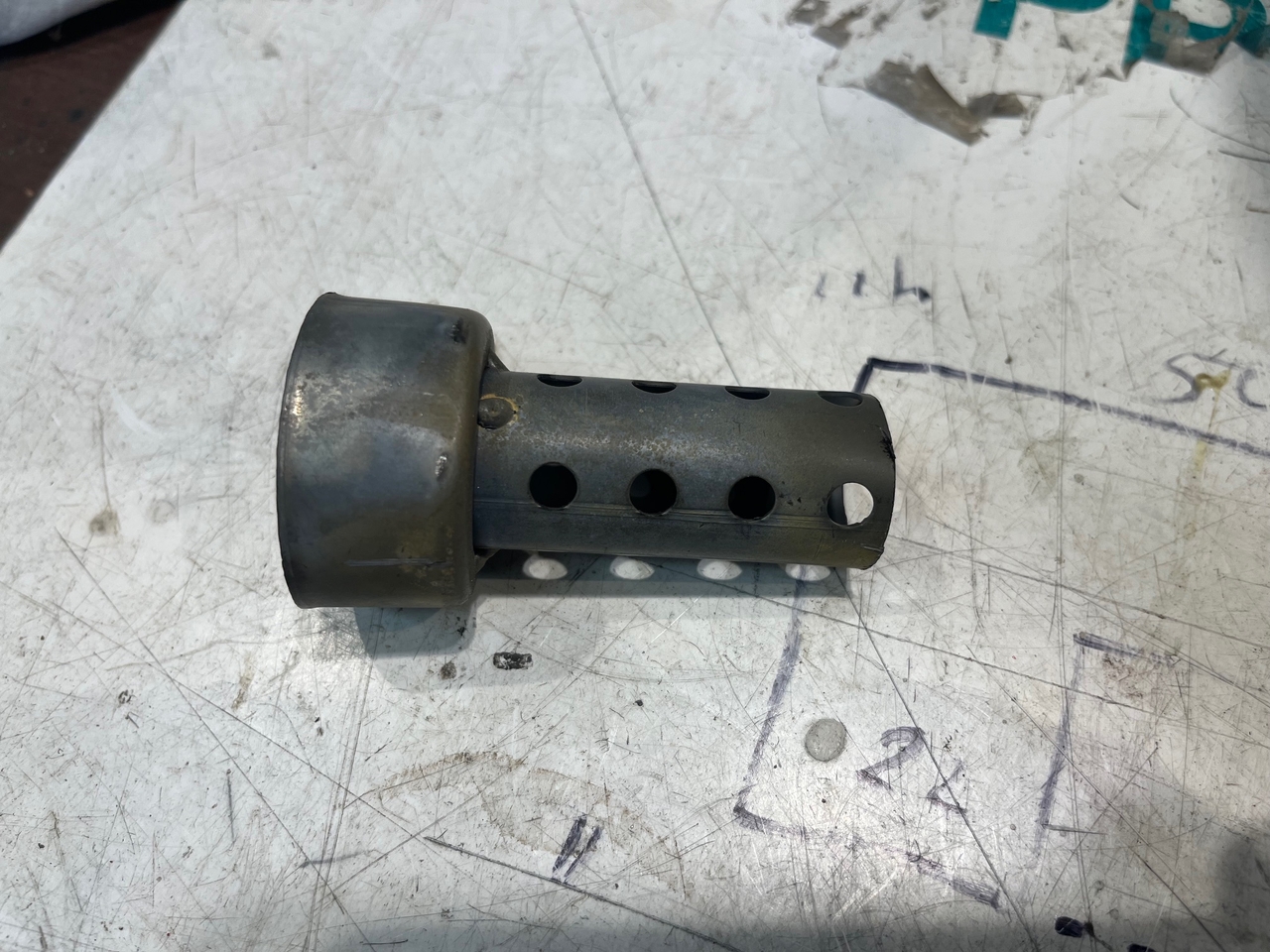

Only problem is that it is a bit too loud. I put the db killer in, now it just sound too quiet 🤔 I know , that’s the point of db killer but i was thinking, is there any way to make it a little bit louder ( deeper sound ) whit the db killer in ? Maybe drill some holes ind the db killer, cut some of the length of the db killer, other advice ? Or is it a no go ?
Anybody had same issue and what did you do ?
Picture of db killer :

Drilling holes in it will make it louder, how many holes and how much louder I don't know but I would try just drilling a couple of holes and see how loud that makes it then take it from there.
Here's an old DB killer I found in a box of parts that I bought, don't know what it was from but you get the idea;

Yes, more holes make it louder. If you google DB Killer Modification you will get scores of hits, maybe even a few youtube videos.

I tried google it , and lots of different advise. Some say drilling holes gives a weird sound and some say I need to cut a few inches of the pipe of db killer for a deeper sound. I have ordered a new pair of db killers solid it goes wrong I have a 2. Try 😊 think I’ll try with drilling holes, if it doesn’t help, try to shorten pipe…

Yes, shortening it will also work but probably a bigger difference than drilling holes.

I had a couple of Harleys with stock mufflers. They sounded more like a sewing machine than a motorcycle. I read a thread that talked about enlarging the holes in the baffle and adding a few more. Worked great, added a little rumble without being loud. Another Harley I got had a Screaming Eagle mufflers. It sounded great until an hour had passed and then became obnoxious. On this one I welded in diverters to take the exhaust glasses outside the baffles and then back through the enlarged holes and then out. I did the same thing quieter without being overly loud. Just experiment, start small.

My solution was to cut off about 50% of the length for the perfect sound.
