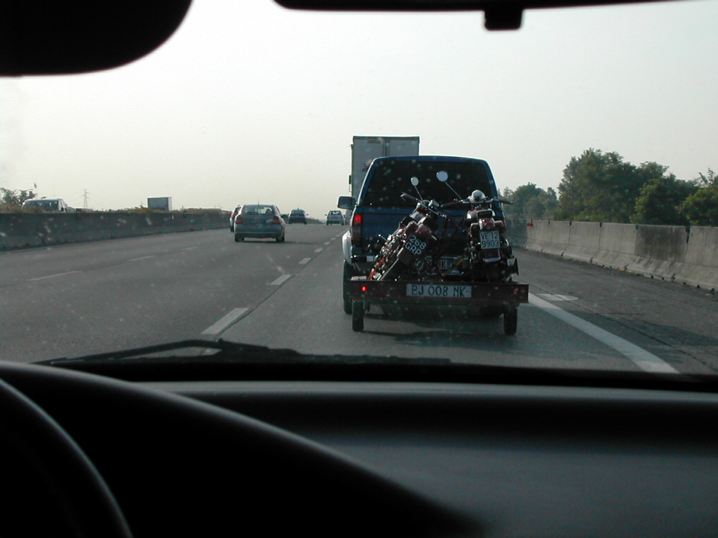

And then there's the Italian version with my Falcone Club.
