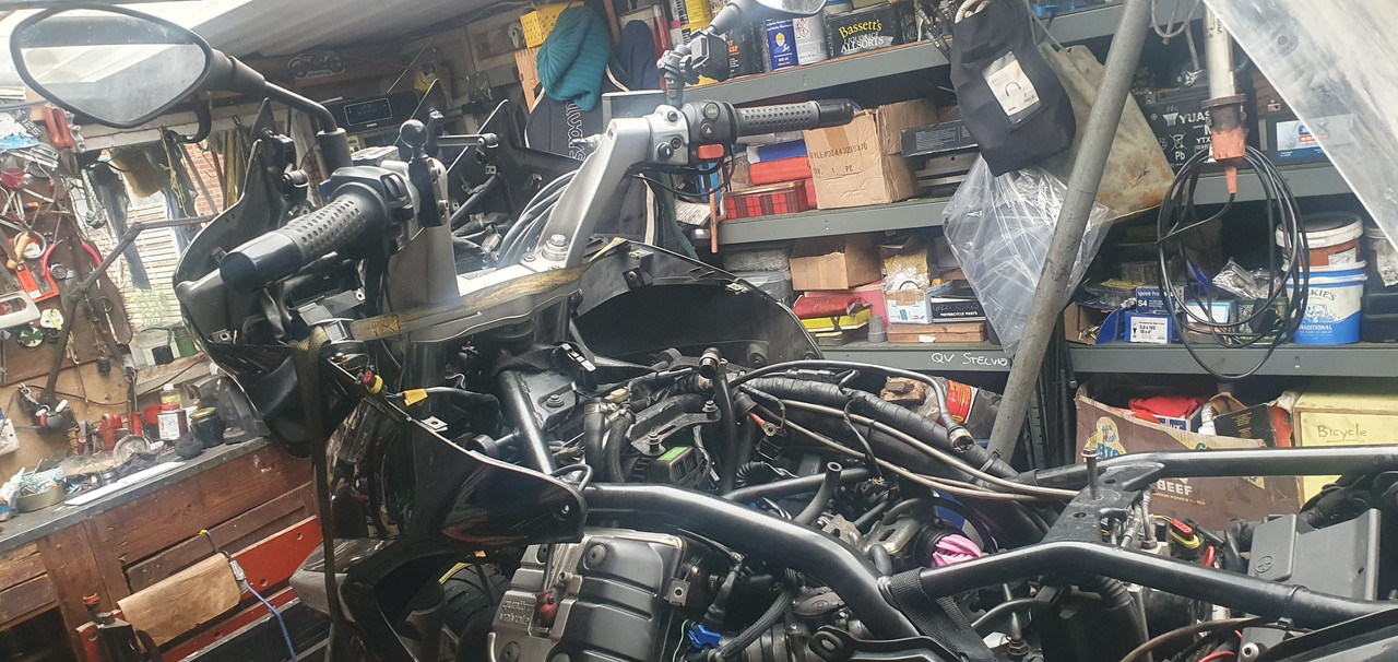

Well laid plans of mine..
I don't want to give the game away on what I'm up to, just yet.  :popcorn:
I've started stripping down the main wiring harness, with a view to replacing it. What a fiasco! I'm on the final stages, having un-clipped numerous connectors, detached the coils, fuse box and other sundry 'bits'. I need to remove the horn to access its connectors and one other that's deep within the headstock. Now that the loom is fairly loose, it's much more obvious on how difficult/tricky/impossible it will be to extract it from the frame, without crazy amounts of teardown eg. throttle body and those specialised clips holding it and the inlet manifold. The location of the ABS controller and plumbing doesn't help either.
I'm really regretting going down this road and any (constructive) insights will be gratefully received.
If I wasn't crazy before..  :violent1:

At least you won't have all the additional connections for 'modern' stuff. The main problem is that the harness on these later bikes are contained within a plastic structure, that has various protrusions, for attaching 'things' to.
The one below (not mine) shows the kinda thing - this one has been opened up for some reason..
