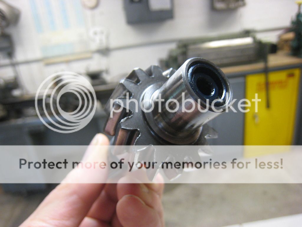

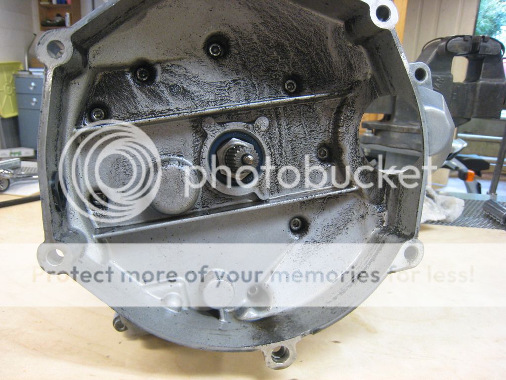

Question:
While using a magnet to extract the inner bearing race, the magnet found the inner pushrod and pulled it from its recess.  I did not pull it out and upon extracting the race, pushed it back in.  All seems well, but did I possibly disturb anything by having the iner pushrod pull out slightly from within?

These photos might help explain the assembly. In the first photo shows the protruding end of the push rod. The last photo shows its seal (#21) within the shaft. As long as nothing is leaking it should be okay.

Excellent photos, thanks much.   ;-T
Looks like everything remains intact if there is a slight bit of movement.  My exploded view of the interior parts was "exploded" and showed parts in the wrong place and scared me a bit.  That seal was the item in question and I can see it stayed put.
