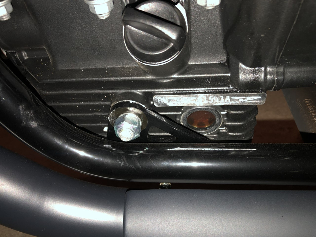

Ooohhhh, follow up question for the V7 850 owners. Do you guys have an oil level sight glass now?!?
« Last Edit: September 02, 2021, 08:08:07 PM by Kev m »
  • Posts: 4747
Re: 2021 v7 850 First Service
« Reply #12 on: September 02, 2021, 08:50:55 PM »
Yes we do! Is this the straw that breaks the camel's back Kev?   :grin:
