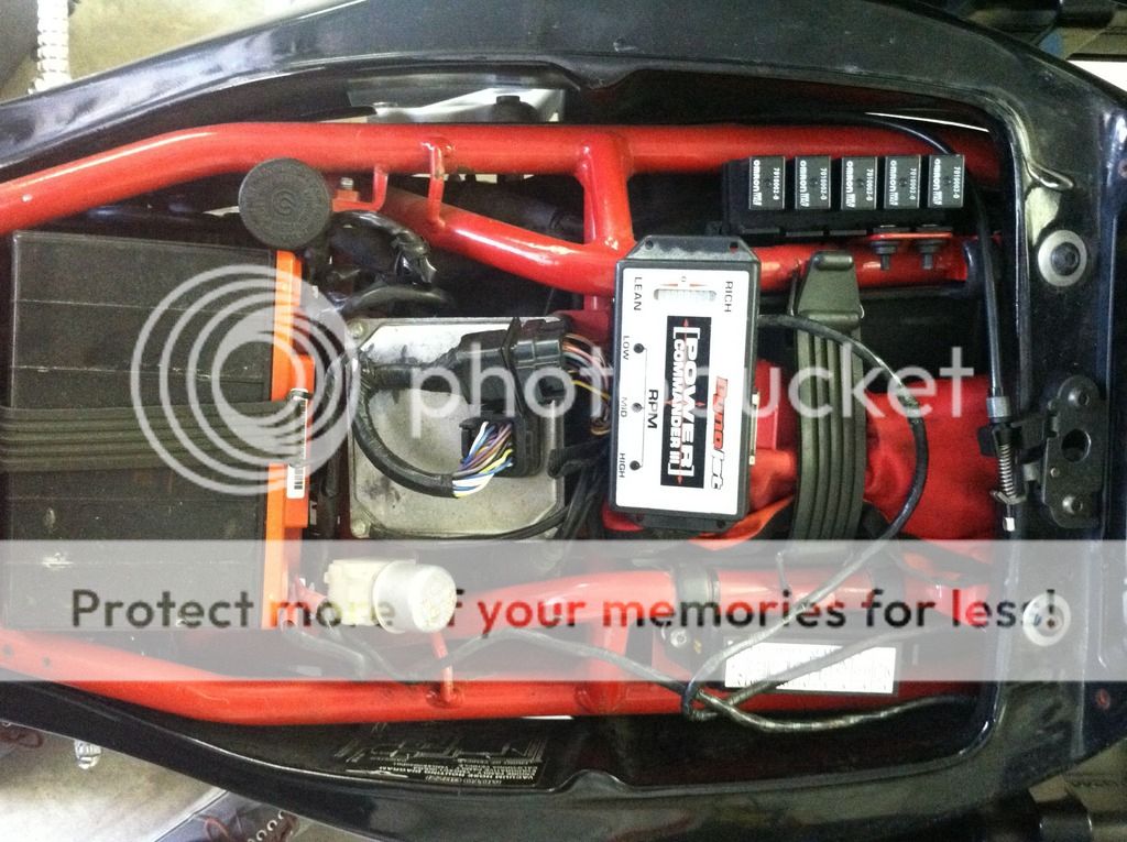

http://i626.photobucket.com/albums/tt345/ddlane212/Mobile%20Uploads/image_7.jpg
Is this how the PC is wired into the V11 harness? Looking at this bike...I'm not familiar with the PC unit and its installation.

Yeah, the PC just piggybacks into the harness. Normally people put them in the tail piece. Looks like the transmission has been apart, so the recall probably was done.
