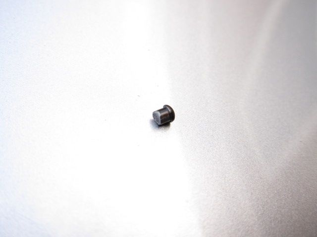

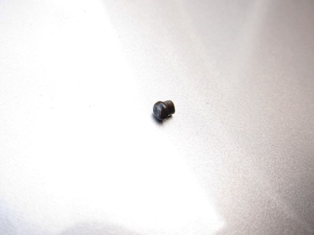

« Reply #33 on: August 10, 2014, 04:30:21 PM »
When I initially stripped my LM2 engine this came out, never did find out where from.
These were the cam followers, I believe they're the originals, after 34K miles. Replaced all 4.

« Reply #37 on: August 28, 2015, 05:22:17 PM »
That looks like one peened end of the "distributor" drive gear pin.
