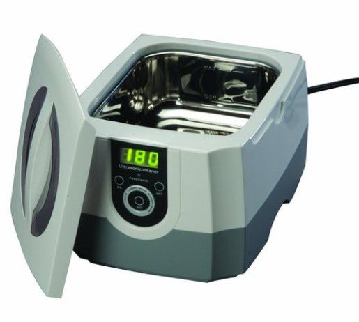

And was looking for tips in using it and recommendations for the type of cleaning solutions available.
I was thinking getting the stuff used to clean gun parts and after rinsing, using a protective spray.

I've used berryman Chem dip and it seems to work well.  I believe I found it in Wally World.
II use an ultrasonic cleaner and find it effective. However, if you have an assembled injector, I don't know if it will be 100% at cleaning out the tiny orifices in the nozzle. I would think you'd want to remove the plunger and spring.  Obviously, pop testing the injector is the only way to see if your cleaning worked.

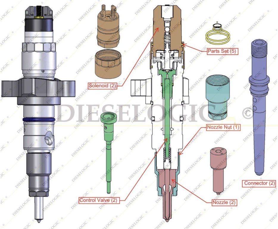

I am interested in your experience with cleaning carbon caked on to steel parts.
I have seen vids of parts successfully cleaned but only after 1 to 8 hours of ultrasonic cleaning in a tank of hot solvent. I don't want to use any smelly stuff with acids or bases that could corrode any of the precisicion steel parts.
Homemade cleaners based on alcohol, ammonia, dish soaps are cheap and I could use even stronger solvents for the smaller parts (metering needle and control valve) in a small glass jar or plastic bag that is immersed into a Ultrasonic cleaning tank of plain water.
The stuff for guns looks like it would work on my injectors once I disassemble them. I am not too worried about the injector tips -  it is the high pressure seals on the control valves that are causing my problem and I want to able to clean the area where the replacement seals contact. There is also a small steel ball in the control valve cap that shouldn't be cleaned ultrasonically. I have replacements for those too.

Thanks for all the info. I found some professional places on the web that showed videos of their procedures. They use 3 stages of ultrasonic cleaning. First one using a very thin aqueous based solvent, second stages uses alcohol and the last stage is a distilled water rinse. Finally, oil is applied to all metal surfaces to prevent flash rusting.
The electronic guys that clean pcb boards will then dry them in a oven at 220F for an hour to get the last bits of moisture/alcohol out of the components. I don't have to use that much heat on my project.
I can use a brass wire brush on the bits of carbon that are still stuck on the valve body.
These common rail high pressure diesel injectors can run up to 27,000 psi and are very expensive to buy new. The dealer is only asking $895 list each! Thaaawft
I really don't have any trustworthy shops nearby that can do a good job on rebuilding them. All the rebuilding is done in the US, and here in Canada all we can do is order the rebuilt units and return the old cores for credit. The shipping costs and the current exchange rate make it difficult. For rebuilt units, we are talking over $300 each, plus taxes plus shipping and another $100 -$200 for each injector core, and all when the replacement of a 50 cent teflon seal will fix the main problem. It is a racket.
Individual repair parts for this type of injector are hard to find. The parts kit (#5) I need is actually 4 bucks. 6 of them are on their way right now from Latvia. Still very cheap compared to replacing the entire set of injectors.

Amazon has that gun cleaning solution in a 16oz bottle of concentrate, has lots of positive reviews, and looks like it isn't as alkaline.
Pine sol and dishsoap? .... ok, I read that the mixture ratio for those is very important. Simple green is good to use too if the temp is kept below 130F otherwise tarnishing of shiny surfaces may occur. Vinegar and water .... too acidic for this job.
Should I use only distilled water for the mixtures?  :huh:

Since I work with sonics, I'll give you my 2 cents.
what sonic cleaning does is enhance chemical reactivity, that is pretty much it. If you use a solution that doesn't have any effect on whatever you're cleaning, ultrasonics won't be of any help. Conversely, if you use a solution that could react with the base material of the part you're cleaning, ultrasonics may damage the part in a relatively short period of time.
This enhancement of chemical reactivity can be several orders of magnitude, so it's not easy to determine what will or won't remove whatever grunge you have or what will or won't damage the part you're cleaning. You might be able to soak a part in a solution for days without ultrasonics and see no effect, but see it clean great after 10 minutes in a sonic bath.
there are hundreds if not thousands of commercial ultrasonic cleaning solutions many for very specialized applications. My advice would be to look for something designed for injectors or carburetors. Chances are these will be most effective at cleaning the parts without damaging them. Companies have put a lot of effort into figuring out what works for that application so take advantage of that unless you just really like to experiment.
As far as cleaning inside small orifices, the typical ultrasonic frequencies 20-50kHz range, will usually go through the walls of the part as opposed to going into an orifice and you should get decent cleaning. Make sure you don't get air trapped inside, which would prevent any cleaning.
