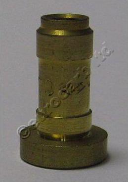

I've run into a brick wall trying to get my Lario back on the road. I need atomizers in the stock size (268) for the carbs, but nobody seems to have them. Harper's has been trying to get them for ages, and before them Dellorto Direct wasn't able to supply them, either.
The carbs are PHBHs, using apparently the same accelerator pumps that the old VHB carbs used. Apparently they come with the pumps and without. I can get the atomizers for the non-accelerator-pump PHBHs, but they don't fit.
Does anyone have any ideas?

Do the atomizers look the same as the VHB atomizers?
Unfortunately, those are only available in 265 and 270.
Yes, they are apparently the same as the VHB pumper atomizers.
Then I would buy a pair of each size (265 and 270) and see which works best. Yes, it wouldn't be "stock" jetting then, but if it works, then that's all that matters. MG Cycle has the 265s:
http://www.mgcycle.com/index.php?main_page=product_info&cPath=62&products_id=2098
and might be able to special order the 270s. If not, Eurocarb Ltd. in the UK has them:
http://www.dellorto.co.uk/shop/dellorto-motorcycle-carburettors-parts/dellorto-vintage-carburettor-parts/vhb-vhbz-vhbt-parts/vhb-atomiser-vhbt-27-30mm-cscd/
Try Harper's of course as well and Herdan Corp. http://www.herdan.com/ (best to call in the afternoon).
