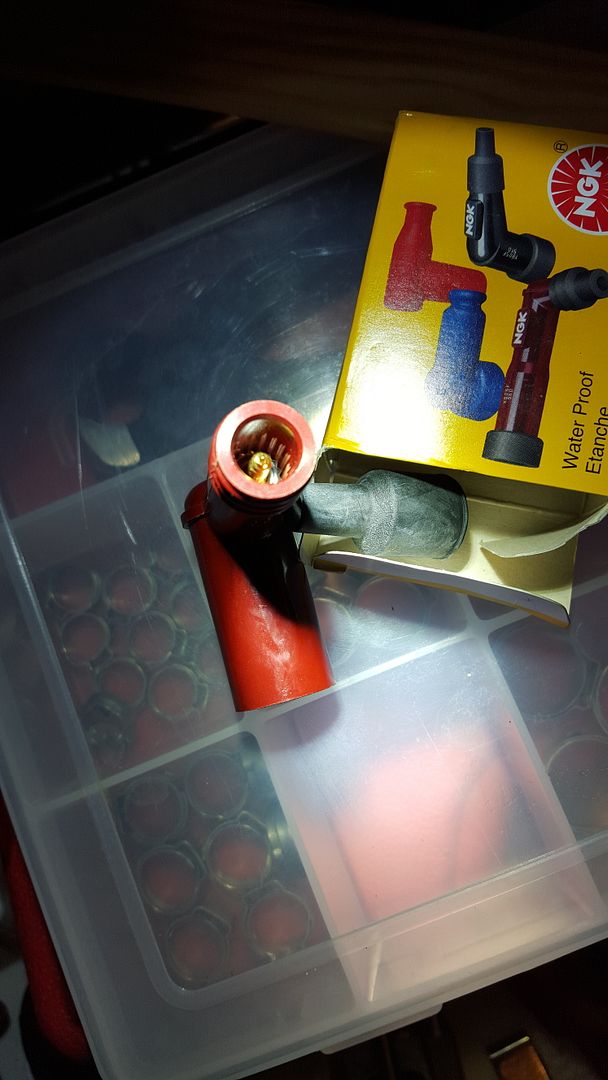

I just about bet that plug wire was the problem.  The boot should screw into the wire, I attached a photo...
I would sure keep an eye on that shock, maybe disassemble it at some point and put a washer behind it, that sure could cause you some grief if it worked loose while riding...
Glad she's running now!

Had a very similar problem a while back. One cylinder, misfiring: pretty much what you described. Followed the sleuthing advice from several folks herein and found the problem was the leads and plug connector. Trimmed .33" off the lead ends and put everything back together while I waited for parts to arrive. Parts are still in the box:adding to my growing inventory of supplies.
And 'yes' the plug boots are cheesy press/twist-on's. I'll just be more careful how I treat them at tune-time.

I just did the boot caps and plugs that were mentioned by the OP in this thread:
http://wildguzzi.com/forum/index.php?topic=79143.0
This appears to have solved my issue, I didn't bother to switch my coils.

That's good, my EV had the nasty carbon stuff, it developed similar symptoms, a weak spark usually shows up under acceleration when it's harder for the spark to jump the plug gap.
Looking back at the picture you posted of the boot it's hard to see the screw thread, do you suppose it's been arcing in there and blackened it?
