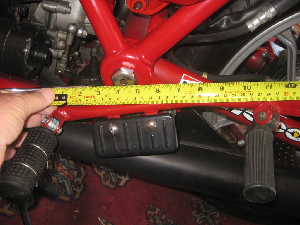

Don't have any to sell, but this might help :grin:

So, John, what is the total then?

« Reply #3 on: October 03, 2015, 12:20:22 PM »
The total bracket length end to end is 13.5"   :wink:

« Reply #4 on: October 03, 2015, 12:24:46 PM »
Wow! Two inches were cut out!  :undecided:

« Reply #5 on: October 03, 2015, 12:37:12 PM »
The back pegs are for the passenger, but I use them on straights for more leg room(30") too when solo riding.

« Reply #6 on: October 03, 2015, 06:51:37 PM »
 Thanks Wayne and John.... I took them to a friends shop with a piece of 3/8" pipe ( 17mm compared with 18mm on the bracket)  and a couple hours later, Bingo, back to stock!
