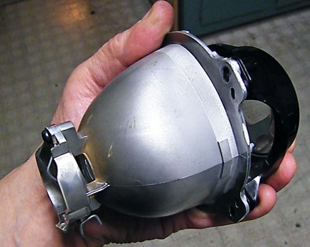

So I wanted to try HID.  After the other alternatives we've discussed here before, I decided to try doing it right -- getting HID projector lights on a Guzzi.
This is a random 3" projector from a wrecked BMW car.  Assuming it was hi/lo (this one is driving light only -- undimmable) it would work good and be free at most body shops.  There are hi/lo's out there -- this just isn't one.  2.5" projectors are smaller than this one and put out about the same light.
After researching what was out there, I went with DDM Tuning's V2 HID retrofit modules, which includes (x2) the projector housing and lens, a bulb, and a ballast.  Choices of ballast were 35 and 55w.  The same bulb works with either.  They have color choices.  I went with 4500k bulbs @55w.

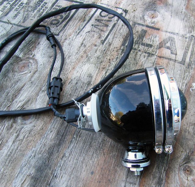

They're halogen bulbs in ~4" housings, but all I wanted was the housings.  At $20/pr I could live with gutting them.  They are ***EXACTLY*** the right diameter and length for the DDM projectors, provided you drill a hole in the back to help mount them.
I drilled through the back of the housings to accommodate the HID bulb and rear mounts.  Then, because I hates me all shiny objects, I powdercoated the steel shells black.  Assembly was straightforward.  I'm using some angle aluminum (not pictured but wait till morning) for brackets.
Although DDM offers prewired kits, I am plumbing mine into the harness, so I made the wire loom.
So there's a pair of 55w HID aux lights ~the size of Harley dresser aux lights for ~$75 in parts.  Junkyard the projectors and your cost will be half of that.   I'm not quite ready to light them up, but I'll update this when I do.

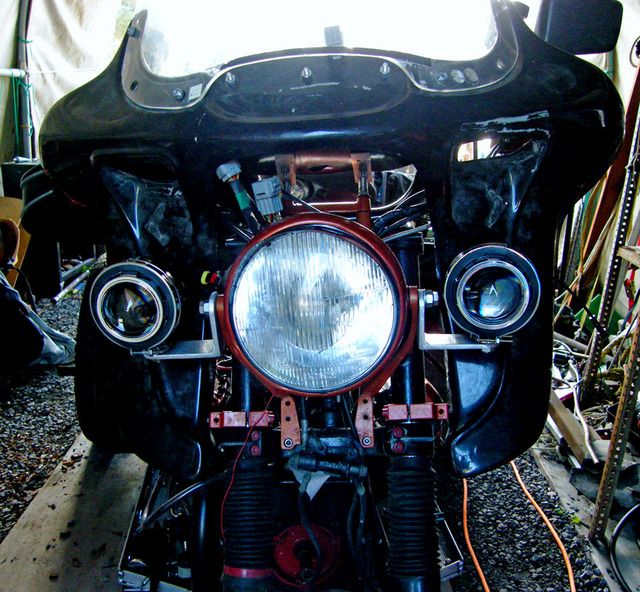

Here's a crap shot of them mounted.  Keep in mind that the mounts aren't finished and the lights are not aimed.
