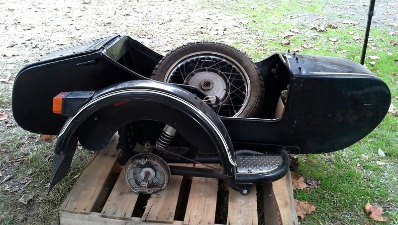

Here it is on a pallet as delivered by Crawford Sales. Came off a "99 Ural BC. No spare or interior/tonneau, but otherwise complete.

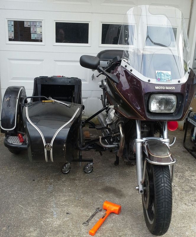

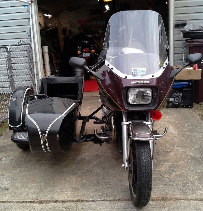

Here is almost a rolling chassis. I bought cast steel lower ball mounts from sidecarpro.com. They were good enough quality. Decent cast steel with some surface rust from storage. Welded them to a 3' length of steel pipe on outriggers from the Guzzi's lower frame rail.
Welded a 1/2" tab to the bikes frame above the rear shock mount for one rear strut to attach to. Still need to make a tab to weld to the front down tube for the forward strut.
Here's the rolling chassis. 3 out of 4 mounts tacked in place. Still need to do the forward strut and make a brace underneath to triangulate the pipe carrying the rear lower mount. Then align it all and bolt it up tight.
