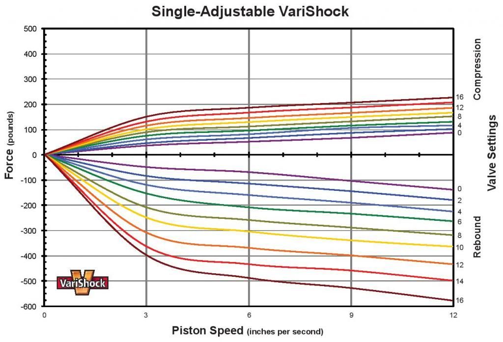

Is there a graph that plots the standard characteristics of a shock absorber?
update: just found this graph: force vs piston speed .... hmmm
Now ....how to compare good settings for a given motorcycle and display the different shocks available.
