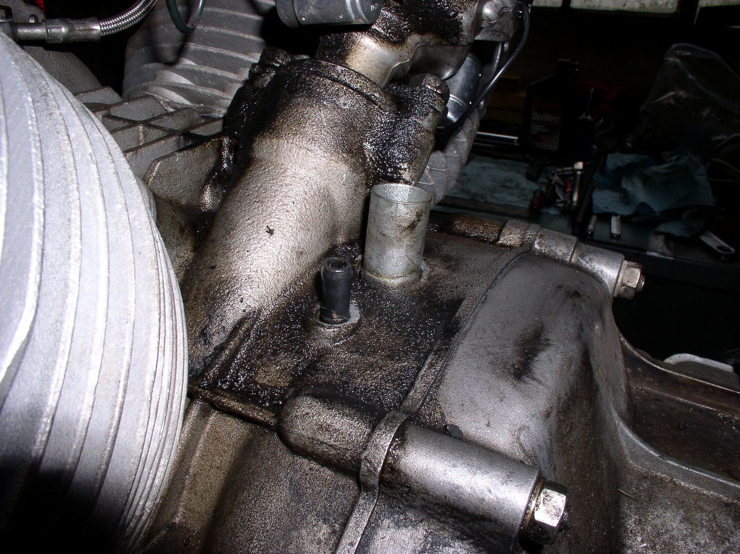

The remaining air-box parts arrived yesterday (or so I thought!). It seems the previous owner installed a different breather box (Le Mans 1 ?) up near the coils, so my T3 Filter and breather assembly won't go in. I now have the T3 breather box, so I can take out the old one, but I now also have to exchange the intake manifolds, because it all doesn't line up. I'm guessing the original T3 manifolds have a sharper "bend" in them. I've located a pair.
Here's my question. Currently I don't have any breather return valve. The hoses just goes up from the crankcase to the breather box near the coils. When I put the new breather in (pushes into the rubber air box) I guess I will need to put in a valve otherwise the suction might do stuff I don't want it to!. How does that plug in there? Any tips on location and orientation appreciated. Unfortunately it is not clear from the parts diagram.
Regards

« Reply #42 on: November 10, 2015, 08:38:45 AM »
Regards
Do you have one of these?
The photo shows it disassembled, the ball goes into the "tube" and the circlip holds the ball in place. The whole assembly then slips into the large breather pipe on the upper rear of the engine "bellhousing" area. This elbow slips down over it and connects to the breather/filter assembly.
The check valve is #50 in the following drawing:
« Last Edit: November 10, 2015, 08:40:57 AM by Antietam Classic Cycle »

« Reply #43 on: November 10, 2015, 09:35:23 AM »
Thanks Charlie,
yes I have one of those and I did examine the parts diagram as best as I could. But I'm not sure whether I have all the bits of hoses. At the moment, an L shaped rubber piece (the picture in your post) comes up from the upper rear of the engine (I believe without a valve) and then points "forward" to the breather box. When I install the correct breather, that L piece will need to point "backward" and connect to the new breather box.
Should the valve be inserted between 2 pieces of hose? Or is it fitted directly to the top of the motor?
I assume the wider part of the valve should be at the bottom, right?
Maybe I'm missing part 25. Is that a metal part? Is it external?
I assume the hoses marked 19 are the breather pipes from the valve covers. But then what is hose 29 and what does it connect to?
Sorry, these question are probably pretty dumb when you've seen the set up. But trying to understand from the parts diagram can be difficult, and you can't always judge from the orientation. When I got the parts 5 and 4 yesterday it was clear what they are, but until then I couldn't guess from the drawing how they should be fitted :-)

« Reply #44 on: November 10, 2015, 10:11:17 AM »
The ball/check valve fits down into #25, a section of which should be extending up out of the engine towards the rear along with #29. The valve will only fit into that pipe one way (wider part up). Hose #15 then slips down over the valve and pipe and is clamped into place.
#29 is a metal oil return line and connects to the breather/airbox assembly via rubber elbow #16.
#19 are the hoses from the rocker covers to the breather/airbox assy.

« Reply #45 on: November 10, 2015, 10:39:06 AM »
Thanks Charlie. So #29 is an internal line?

« Reply #46 on: November 10, 2015, 11:05:54 AM »
Both #29 and #25 are inside the "bellhousing" area of the engine except for about 25 mm or so that sticks up out of the engine. It should look like this (except hopefully not as greasy  :wink:):

« Reply #47 on: November 10, 2015, 11:13:40 AM »
Aces!
Thanks Charlie, especially for taking the time to take a picture!
It's all perfectly obvious now, but when you have none of the original parts and you're relying on a drawing, some questions arise! And I really don't want to have it sucking oil into the carbs!
