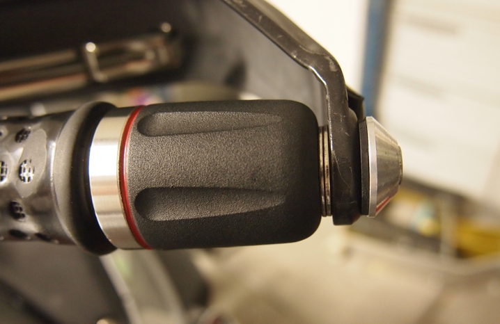

The Stelvio handguards can be used with a Throttlemeister installed - I have this on my bike (backup in case my cruise fails). What you need are some longer machine screws of the same type  as used on the Stelvio guards, some thin SS washers and some rubber washers. On the throttle side, you sandwich the washers between the guard and the end of the Throttlemeister, making sure two SS washers sit together between the Throttlemeister and the rubber washer  that sites next to the guard. On the outside, use a rubber washer and then the beveled collar for the machine screw. Some fine-tuning of the shims for the Throttlemeister pressure may need to be done.
On the left side, just use a SS washer and a rubber washer on each side of the guard's attachment point, with the rubber touching the guard and the steel to the outside of the sandwich.

Here are some photos of the LED turn signal strip on the guards, and how I installed them over the Throttlemeister (note the washers!)...
LED strips (available from a variety of sources, get the ones with genuine 3M adhesive for better results!):
Throttlemeister:

Indeed it is - while the longer unit is not needed for vibration reduction as it would be on a tubular handlebar, I prefer them for both aesthetic reasons and ease of use (especially with gloves on). OK, it's about $10-15 more, so I had to take off my red suspenders...

Washers between the bar weight and hand guard on the side nearest the handguard aren't needed for 2012 and up. An additional washer is needed between the bar and weight to allow the throttle to turn without friction.
