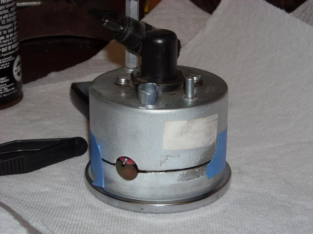

Uncrimping a speedo or tach is just foolish.  Get a Dremel tool with a cutoff wheel and slice all the way around the can.  I like to cut the speedo's in line with the odometer reset hole.  Then some five minute epoxy to put them back together.  Scrape the epoxy line with a razor blade and then use some aluminum tape to reinforce the joint. Crimping is just too hard to get right. This way you never have to worry about the seal or the glass. Any dust from grinding can be blown out and really we are not taking them apart because they are working great anyways.  Mine has been fine for many years now.  Another plus to this procedure is that I can open it up easily again and again to make any other adjustments needed. Mike
Re: Veglia Speedometer Fix
« Reply #9 on: December 16, 2015, 05:39:06 PM »
That's the way to do it  :thumb: :thumb: :thumb:
