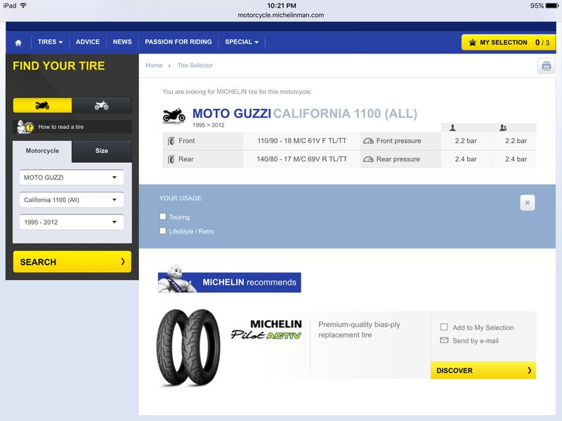

Michelin's recommendation for California 1100s is the Pilot Activ.  The website says they are well-suited to touring. I believe the air pressure values come out to 32 psi-front, 35 psi-rear...

I ran the Michelin fitment guide (from their website) for Moto Guzzi California 1100 - All Years - they had no recommendations.
