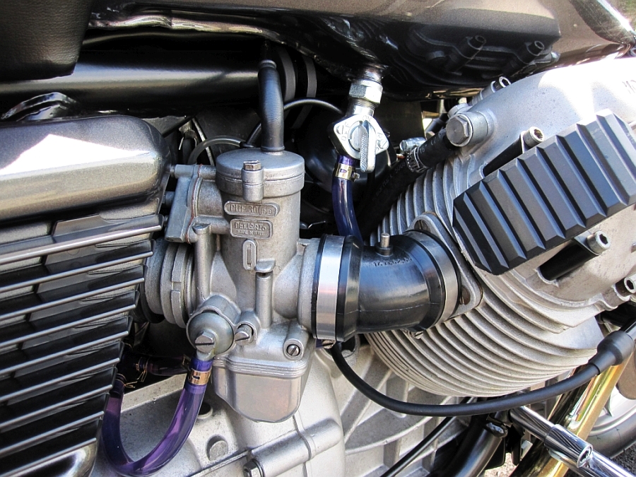

Are the physical dimensions (other than the bore) the same between the 30mm and 36mm Dellorto PHF pumper carburetors? How about the threaded part? Would the factory "velocity stacks" from the 30 PHF screw onto the 36 PHF?
My '81 G5's current/factory setup:
Also, here are a set of 36mm which I think would be the correct ones for the upgrade the OP is asking. Not sure if that price is good or not (haven't compared)
http://www.ebay.com/itm/Dellorto-PHF-DS1-DD1-36mm-PAIR-carburetors-Moto-Guzzi-1000-SP-III-4676-4677-/172018620731?hash=item280d1bd93b:g:EFoAAOSwfZ1WYPK8&vxp=mtr
I put some holes in my factory Airbox (I don't have a photo with me), and I'm happy with the results. Gave the bike that little something it needed apparently.

Your G5 setup is exactly what my CX setup was.  Now I have delrin intakes to my 30 mm PHFs.  Got them from MG Cycle who told me what I had to do to make the switch work.   Since the delrins aren't made to support your carb weight alone I use long zip ties to frame tubes to take the carb weight off the delrins.
