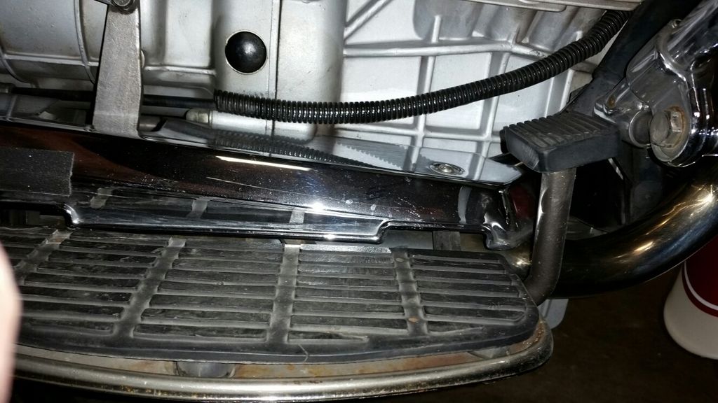

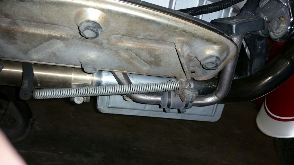

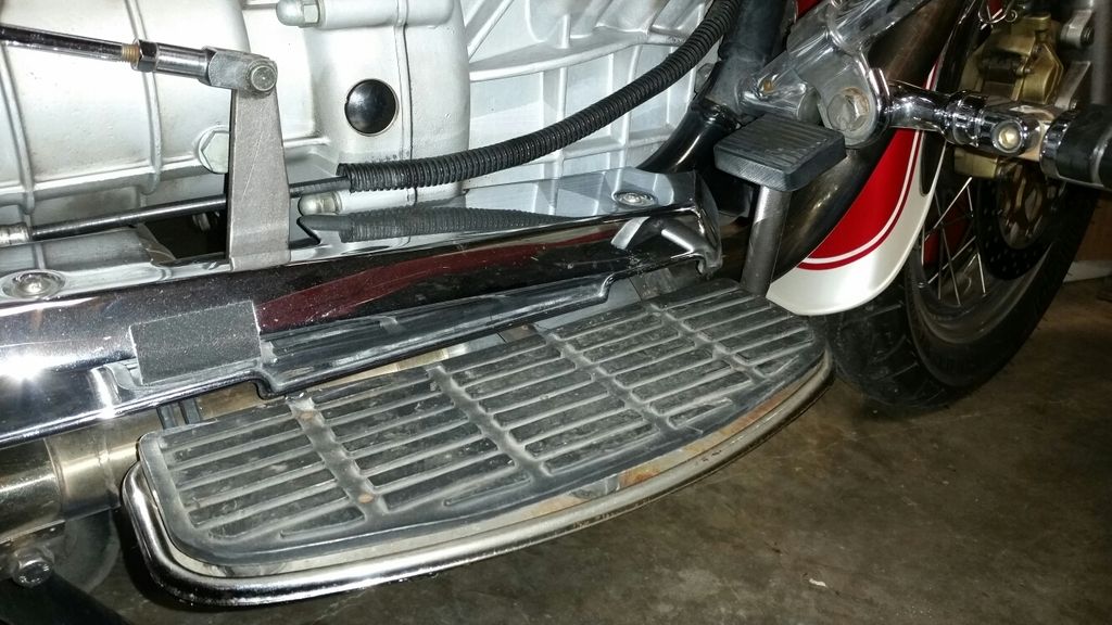

Re: Treadle floorboard for converts
« Reply #15 on: March 21, 2016, 11:37:29 AM »
Here's the one I made back in about 2003. Ive put about 80k miles on since and would never go back. I wear a size 14 boot so there was no way the stock one would work. I t took me a couple hours with a torch and a Lincoln stick welder.
Nice work there.With size 14 boots I can see why you needed it.Did you increase your mechanical advantage?
