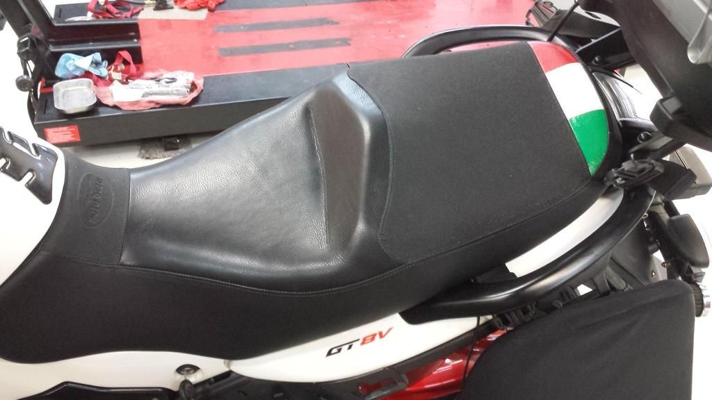

http://s1308.photobucket.com/user/kingoffleece/media/NorgeSeat1_zpsiximxtnq.jpeg.html?sort=3&o=0
Here is a custom King of Fleece LLC seat for a 2012 Norge.  We've completely rebuild the interior to add 1" of height with our version of "super foam" and our unique version of gel that goes below the foam next to the seat pan, a high grade leather insert at the drivers seating area, and a little bit of color at the rear just for fun.
IMHO the Norge is about perfect except for the horrible soft seat that's too low and way to soft to support over hundreds of miles.  The good news is that it's easy to fix.  I also fixed my V7 seat to be all day comfortable.

More than a few of us like a lower seat. I bought the gel OEM seat for the slightly lower height, make anything like that? Gel works great in cold but does retain heat in summer.
Nice looking seat though. Classy.

I can lower seats also but at my 32" inseam I needed a bit more.  I also raised my already tall Tiger 1050 seat-it's what works for me,
As for gel, after having all types to try and use I never put it in as in insert under the cover for two reasons.  First, gel, as you mentioned, gets hot and retains the heat in summer.  Second, and this is a lot more complicated so I'll make it short, I use an engineered controlled rebound "gel" that's shaped like a waffle, but the spacing is different in the columns.  This is placed directly on the seat pan when it's stripped and then the seat is built up from there.  It's also not very thick.  The construction method allows for a firm, and at the same time, forgiving ride isolated from most vibrations.
That said, I just like the way it looks.  Working on another one soon for a rider and it will have a slightly different look to it.

Good work -- that's a nice looking seat !

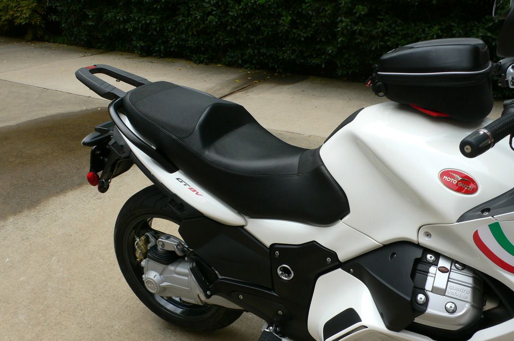

Thanks to King of Fleece for the quality seat rebuild !  Put 300 miles on it yesterday to try it out, it's a mighty fine seat.....

Where did you get those front fairing emblems (green & red)?

Those Italian flag decals are a mystery to me.  I got the bike used from a Harley-Davidson Dealership (of all places) in Austin, Texas, and the previous owner had put them on.  I originally thought I would remove them, but then decided I would keep them as I haven't seen another one like it ....

Very well done.  :thumb:

I agree, It's just personal preference.  I decided to rebuild the seat because I kept sliding forward on the stock seat until my knees were up against the cylinders and I was half way sitting on the tank....  King of Fleece was able to change the angle of the seat by building it up in the front, fixing that problem.
