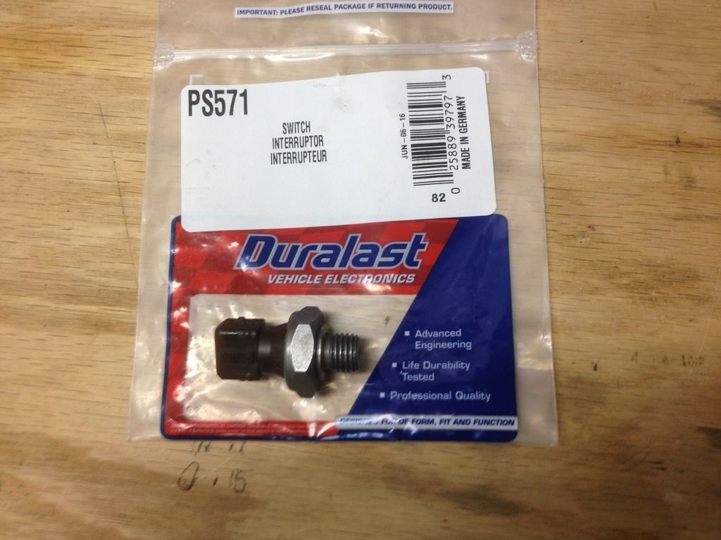

Here it is again, available from Autozone for $10.99 USD   -   Duralast PS571
The only difference from the OEM oil sensor that I can see is that it takes a 24mm socket vs 21mm on the original.  OEM sensor shown on the left.
pete roper
Excellent, tthat was the part you posted before I believe. I don't think we get the Duralast brand here hence my search for something else. Good info though, thanks.
