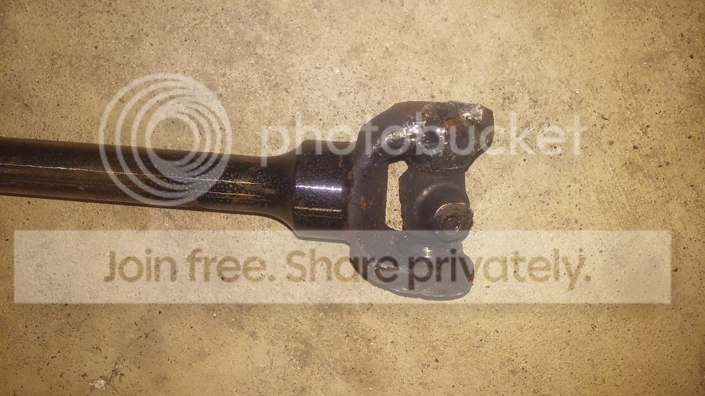

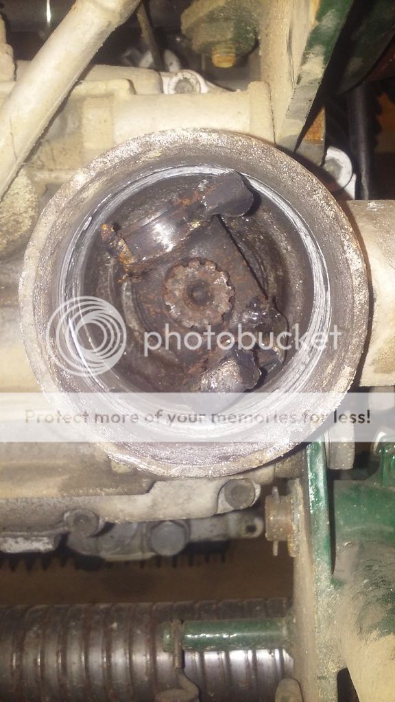

Finally got to taking the swing arm off. U-joint is trashed, everything else looks good. So how does the yoke from the output shaft come off?

« Reply #14 on: July 01, 2016, 07:24:38 PM »

I got it off, needed some convincing though. Now to see what we can fit on there.

http://www.ebay.com/itm/09-Moto-Guzzi-V7-Classic-Drive-Shaft-26F-/131571064723?hash=item1ea23f1f93:g:mmIAAOSwjVVVraVq&vxp=mtr
Is there anywhere/anyone that can tell me if this is the same? Looks the same. Not finding anywhere that gives me specs on mine or this one.

Just finished a 900 miler? And then it breaks after getting you home...that there is the Popes blessing in effect. Happens all the time. Can't tell what bike you own to see if that one fits
I have a 1984 V65c. I have messaged the seller to see if he will get me some measurements. The drive shaft end has the same spline count as mine, hard to tell about the yoke.
It's the same part number and MG Cycle lists the V65C and the V7 Classic both as using it.

That is what I needed to hear. Bought it. Thank you for your help. The old one was a bit rusty, sat in a crummy shed for 15 years. Really didn't surprise me when it went, don't remember if we checked it or not when we were resurrecting the bike.

Drive shaft came in today. Took apart the cross, greased, and reassembled. Smooth. Getting the bike back together was a bit of a trick but I got it done in 30 mins. Will be riding her to Elkader. See you there.  :bike-037:
