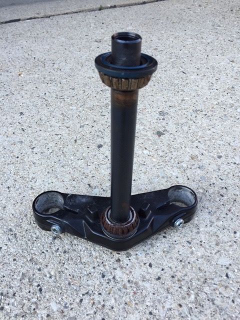

Canuck 750, looks like I have the opposite problem of that tool you describe...the bearing is stuck on the stem and not in the frame.
Here's the pics. Bottom bearing was totally rusty. The top bearing is very loose and falls apart.
Ken

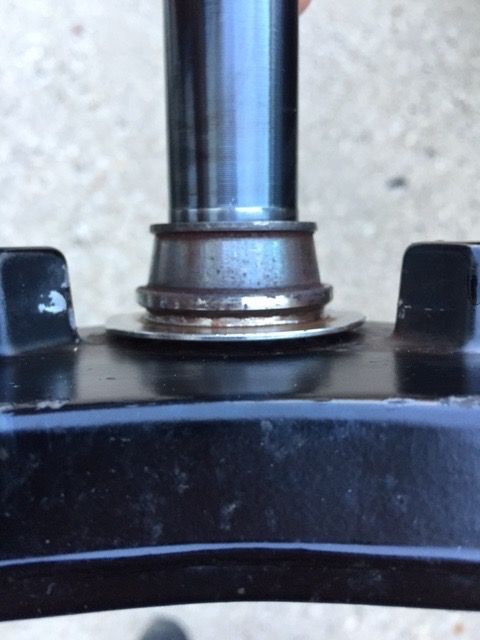

Here's what I have left if the bottom bearing to remove:
Ken

pete roper
Re: V7C steering Head Bearings
« Reply #6 on: August 24, 2016, 01:28:40 AM »
Grind that sucker off! Just be aware there is an alloy spacer below it and the we should be a rubber water/dust seal that sits under that. That's the reason for the lipped alloy spacer. If that was missing it explains why the bearing got so rusty!
As for getting the new one on? Put the dust seal on and Pocatello the spacer/collar in it. Slide the bearing down as far as it will go on the stem and then use a piece of pipe that fits over the stem but inside the cage so it sits on the top of the race to either press the bearing down from the top, (If you're careful you can tap t down tith a hammer.) until it seats on the spacer, or invert the whole lot in the press and press the stem through the bearing until it seats.
Ground off without issue. No dust seal on the bottom. Will order 2 new dust seals and install when they arrive.

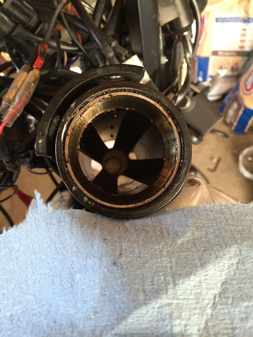

The seals arrived from Harper's on Saturday, but we were out of town (the wife was rappelling down the side of Lambeau Field Stadium for a fundraiser, and I was able to longboard around the stadium while she was prepping for it).
I had at it tonight. I was able to remove the 0uter races with the tool Cunuck750 mentioned (mine was a 4 prong version), and the new races installed with a kit I rented from auto zone. The bottom bearing was installed on the steering stem with a pipe as Pete mentioned above, and a hammer was necessary as I'm a weak little person. The bearings seems to be torqued down according to specs, and all is good.
For those afraid of messing with bearings like I am, have no fear. This was very simple and easy...it just requires common sense and a few special tools. The people on the forum were a huge help!
