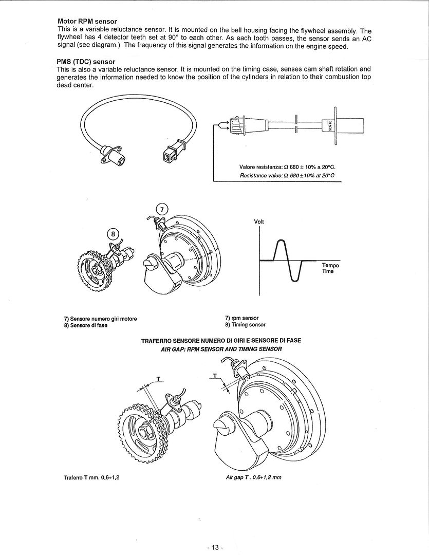

from the manual,
- 24 -
TROUBLE CODE 1.2
Phase  signal (TDC) failure
The trouble can be in the sensor itself
 (circuit opened), in the wiring or in the connector (circuit opened). It
can  also  be  caused  by  an  excessive  air  gap.  When  th
is  fault  is  intermittently  occurs  during  running  the
code 1.2 is present together with the code 1.3.
When code 1.2 is present with code 1.3, check the air gap on the timing case sensor.
found here,
http://www.dpguzzi.com/efiman.pdf
page 24
I think phase sensor refers to the Cam sensor not the crank sensor but they are the same so buy one and try in cam hole first.
« Last Edit: August 31, 2016, 07:52:02 AM by fotoguzzi »

  • Posts: 20003
Re: Crank sensor question 1996 Cali
« Reply #16 on: August 31, 2016, 12:28:22 PM »
Found my new one -- CAM sensor.  It is a more or less perfect cylinder -- no "swelling" look to it anywhere.
I don't know how the two sensors work together.  The 15M does it all with a single sensor.  Part of what I'm trying to learn is what the crank sensor actually does on the P8.  There is very little written about this stuff.
Motor RPM sensor
This is a variable reluctance sensor. It is mounted on the bell housing facing the flywheel assembly. The flywheel has 4 detector teeth set at 90° to each other. As each tooth passes, the sensor sends an AC signal (see diagram.). The frequency of this signal generates the information on the engine speed.
PMS (TDC) sensor
This is also a variable reluctance sensor. It is mounted on the timing case, senses cam shaft rotation and generates the information needed to know the position of the cylinders in relation to their combustion top dead center.
source: http://www.dpguzzi.com/efiman.pdf
« Reply #17 on: August 31, 2016, 12:44:43 PM »
Yes, that's about as much detail as I can get, too.  I'm going to have to wait till I get south and unpack the oscilloscope to really figure it out.  Remember those old automotive diagnostic scopes?  They worked good to give a picture of all that if you got creative with the leads.

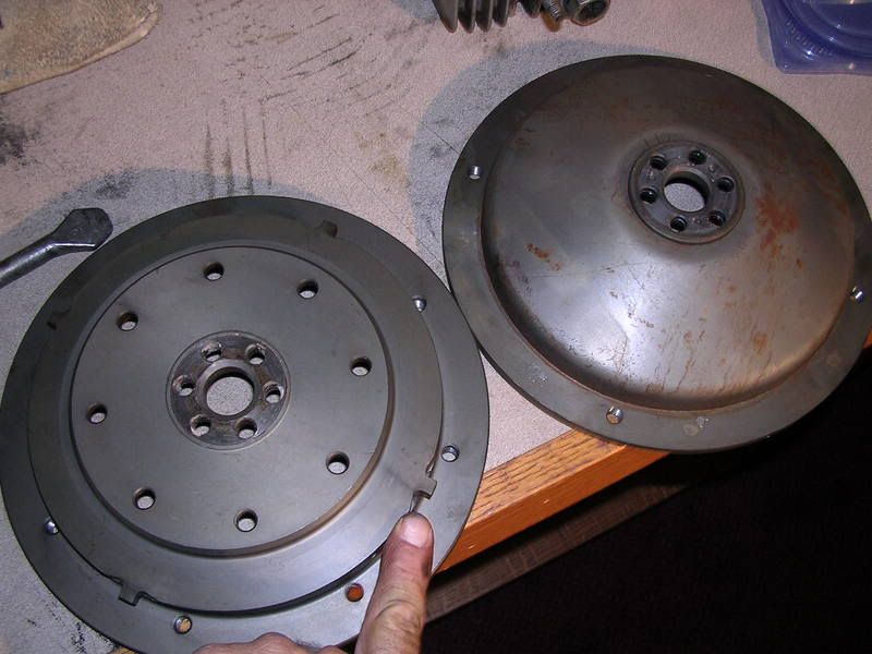

Offline Wayne Orwig
  • Posts: 14097
« Reply #18 on: August 31, 2016, 01:13:40 PM »
Motor RPM sensor
This is a variable reluctance sensor. It is mounted on the bell housing facing the flywheel assembly. The flywheel has 4 detector teeth set at 90� to each other. As each tooth passes, the sensor sends an AC signal (see diagram.). The frequency of this signal generates the information on the engine speed.
PMS (TDC) sensor
Something doesn't add up.
The flywheel, for the P8 and Digiplex, has a 'double tooth'. That double tooth is for detecting TDC on the right cylinder.  So the bell housing/flywheel sensor is for TDC. Try mounting the flywheel out of time and you will learn that lesson.
« Reply #19 on: August 31, 2016, 03:09:59 PM »
Are you saying the sensor has to be in a specific location on the flywheel, the document seems to indicate there are 4 targets but doesn't specify where.
It would sure suck to have to pull the flywheel again just to re-locate it.

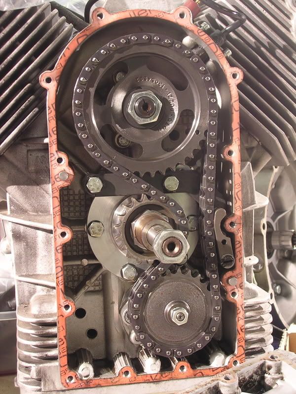

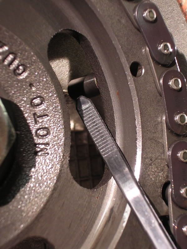

  • Posts: 20003
« Reply #21 on: August 31, 2016, 04:13:51 PM »
98 EV
Flywheel with four pegs,
disregard that it has a Convert cam, the cam sensor was a pin on the cam gear not a phonic wheel like later 15m with no crank sensor.

A crank sensor can't tell when to fire a plug on a multi-pot 4-stroke engine.  You need a cam sensor for that.
Offline Wayne Orwig
  • Posts: 14097
« Reply #26 on: August 31, 2016, 08:25:18 PM »
I assumed it fired twice.
The flywheels I looked at, one of the four tabs had a cut in it, to produce a double pulse at TDC.
In the case of the Digiplex, it only had the flywheel sensor, no cam sensor. So it had to have a waste spark.
Maybe the double tab thing was just Digiplex.
« Reply #27 on: August 31, 2016, 08:40:53 PM »
I was supposing a dedicated spark system.  I never thought about which system guzzi efi would use.
