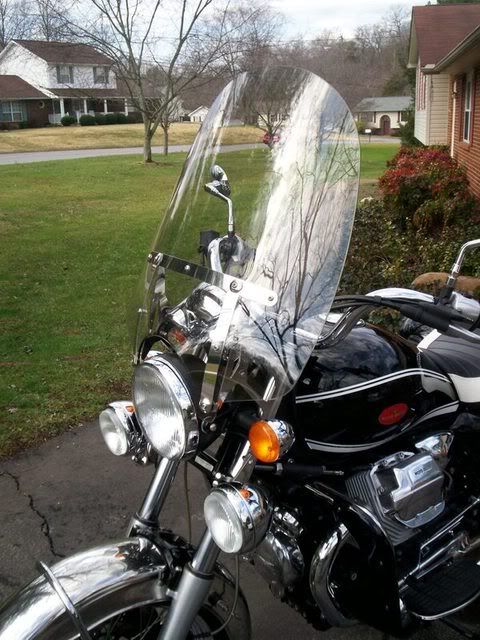

Had any Calvin owners attempted to incorporate the EV wind deflectors to a Calvin. I do t mean to beat a dead horse on this subject just trying to get the wind blast off my face. Shame on the aftermath accessory companies for not including Moto guzzi with the jap bikes and Harley's. not kicking either as I have owned most every bike out there. Sorry for the frustration rant:(

I believe these will only work on a Vintage if the spotlights are removed or modified. I fooled around with some homemade defectors with mixed success. What worked for me was the installation of Vetter Pop-Vents on the shield. It evens out the pressure and reduces the updraft from the bottom of the shield. Far less buffeting, too.

Sheepdog, how does the vents keep the wind from coming under the bottom of the shield and upwards to the face, I can't seem to rap my heD around how that works?
On the Shawnee fairing, they are a great looking deal however I'm not ready to turn loose of 700 bucks just yet, if I can just improve what I have for the time being. Thanks for all the responses guys.

Lots of air comes up from under the shield because the air pressure in the front of the shield is much higher than behind it when the bike is at speed. This pressure differential causes the high-pressure air to rush around the edges of the shield to equalize the pressure. Since the lower edge of the windshield is the furthest forward, the rush of air is greatest from there. Placing vents around the middle of the shield allows some equalization of pressure, keeping the updraft at bay. Additionally, it creates a laminar flow of air that smooths the buffeting over the top of the shield. Look at the Swannee fairing mentioned by lazlokovacs...it has a vent right at the base of the windshield. This is a common solution to air management issues on motorcycle fairings.

Sheep, if there is a gap of about 1 inch between the headlight and bottom edge of the shield does that serve the same purpose as the vents? I'm just afraid I'll attempt the drill the holes an shader the shield I just paid 180 bucks for.

I've heard some folks say that turning the windshield mounts upside-down will give you that 1" gap...and that it helps with buffeting. I expect that it will reduce updraft as well. It just looks kinda funny...
