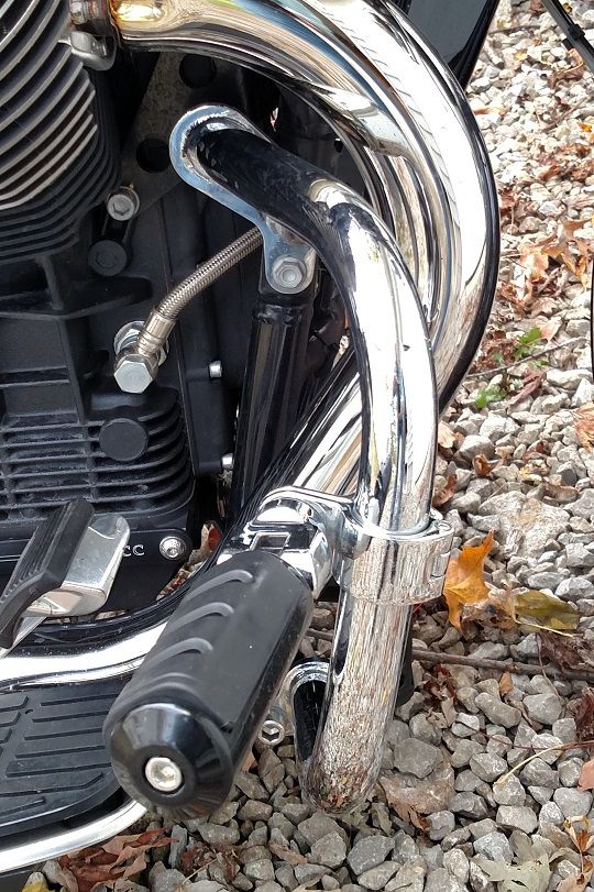

Just picked up this 2007 Norge. It has some needs. Has 36K miles on it. Some aftermarket stuff (aux lighting, elect windshield motor spins but screw no longer attached to barrell, right side grip heater not heating) New rear tire last week. Plan to document repairs/mods as I go.
Exhaust is too loud and collector had a crack, see photos.
Anybody know who made this collector?
Can't believe I bought a Guzzi.

Got the crack welded. Is this collector OEM? I just assumed it was aftermarket.

« Reply #4 on: January 12, 2026, 04:16:34 PM »
That’s the real thing..
They’re made from fried pasta… :drool:

« Reply #5 on: January 12, 2026, 05:11:18 PM »
Not 100% sure on this as my two Norge models were 8V, but on most US spec models, the 'collector' is a catalytic convertor. I seem to recall the same on a few 4V motors I've seen, but others with US Spec bikes can say definitively.  I find that by removing the cat the motor feels a bit more spunky, and revs to redline faster. I have the mistral bypass pipe and can on mine.
Because I'm stoopid, and got confused when looking at the Griso and 1200 Sport, and going on memory with the Norge, I ordered the wrong bypass pipe..... It did NOT need an 02 sensor bung, they are in the headers...... I ordered it in January knowing it would take till at least April to get it, and I was picking the bike up in April. Didn't realize the snafu until I went to swap it out in June. No problem, I had an 02 sensor bung.
Looks like you have it straightened out with the weld, but you can buy an Agostini or Mistral collector/crossover from MG Cycle, AF1 Racing, and I think GT cycles. Probably other places as well including Ebay.
