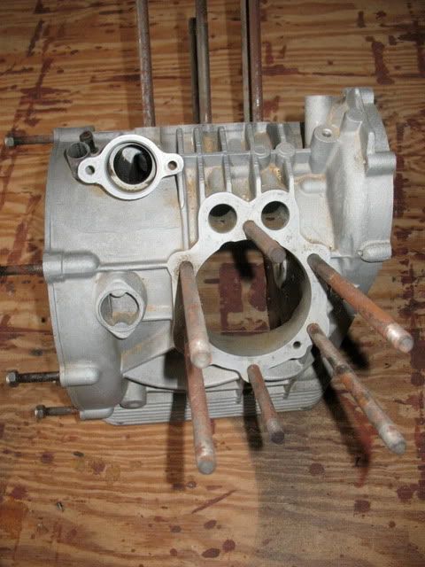

Offline Rusnak_322
  • Posts: 379
Soda blaster
« Reply #14 on: March 04, 2017, 08:00:23 AM »
I did the frame and engine on my T3. Your compressor maybe small. What that means is that it will air pretty quickly. I could be done, but may be frustratingly slow.
First pic is after soda blasting / the next is the before.
I blasted in a area that i usually keep the garbage cans, just to keep the dust somewhat contained. It was great to prep the surface for paint, but the engine didn't look anywhere near as good as those carbs that I did.
I also did my frame, but again, it was more of a cleaning step to prep for paint rather than a stripping operation. This is what the paint looked like after the soda blast. I could remove paint down to bare metal, but it was very slow going and not needed.
