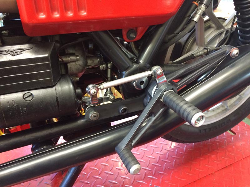

I've used reverse shift for many years now (my first bike had reverse shift on the left side and it just feels 'right' to push down when accelerating etc.).
On my Ducatis it is really easy to swap over and even better with a direct lever that eliminates any slop.
I got the LM2 just 2 years ago and wanted to change it over so that all my bikes were the same but it's not so simple due to the way the linkage works.
Apparently it can be done by changing a component in the gearbox so that it actually reverses the selector? but I really didn't want to start taking the gearbox off/apart so I devised a new linkage for the Tarozzi rearsets that I bought, I did nothing irreversible to the bike and other than a bolt-on adaptor plate just needed to mod the Tarozzi link arm.
Turned out good, there is some slop that makes getting first gear tricky when the engine/gearbox is cold - the 'trick' is to let the clutch part out so that it is not fully disengaged and then select first/pull the clutch simultaneously but it's only a problem for the first few minutes of running and then all is good.
