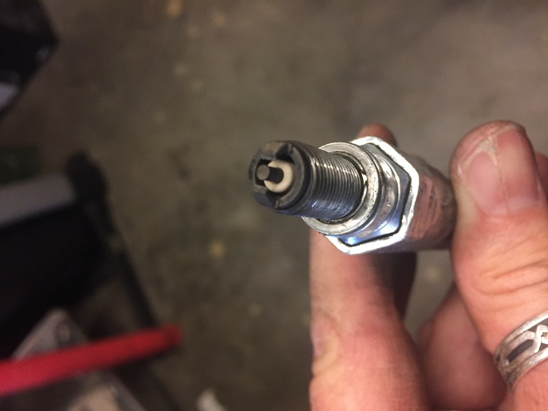

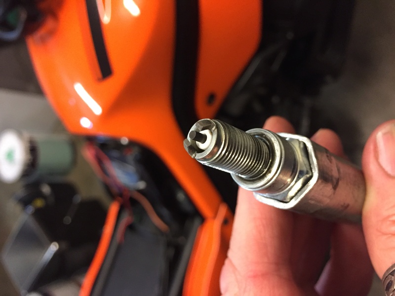

Big smoothie that can pull down small buildings. All finished now....
Spark plug porn:

Awesome!   I am curious if you ended up with anything close to a factory 1400 map , if that even makes sense. Your plug looks a bit richer than either my griso or 1400.  I'm glad it all panned out for you guy's. You must be getting whacked with inquiries from all over the planet and beyond.  Would love to see a video some day of you and Pete doing side by side roll on's .   Or maybe Pete doing a wheelie tutorial. :thumb:
Spark plug porn:
You can't really compare. Cali 7SM maps have three maps per cylinder, plus the three riding map modes. One "main" map, and five correction maps. Effectively 6 maps per cylinder. That excludes MAP sensor correction and temperature correction tables. I'm still try to figure out how they're applied. The 5AM is pretty basic by comparison. Then there's the single throttle body vs dual throttle bodies.   :shocked:
I'm extremely happy with that plug. About as perfect as it can get.

« Reply #82 on: January 11, 2018, 07:28:25 PM »
You'll never see me do a wheelie tutorial or even probably a wheelie, not because I don't from time to time but if I was asked to do it on demand I'd almost certainly screw it up or fall off! :D
As for the plug it's very nice, the air/fuel ring is the textbook! This is one of the things that certain other people overlook. If you only pay attention to the EG-AFR and don't actually consider how an individual engine design will work you can end up way off target in terms of the mix and the burn itself can be altered and changed by factors like spark advance and engine speed.
Of course EGA is used! Mark logs data using a WBOS on the road as although more time consuming and more hard work than using a dyno it also allows analysis of what is happening in real riding conditions rather than just taking a few points of throttle and applying load on a dyno. But then those findings are combined with a host of other tests and examinations and plugs are still a vital tool of discovery as they will tell you exactly what is happening inside the combustion chamber, not just in the pipe, which as we've tried to explain before, on the 8V is a somewhat odd environment due the the charge transition issues that affect it, (The same issues that make it such a thirsty pig of a thing!)! Thing is while there may well be a theoretical *Ideal* AFR, (Being very simplistic.) relying solely on EGA is not only naive it won't render the best results!
I've said it many times over the years but it's worth repeating once again you have to look at an engine holistically. They are each and every one of them an enormous melting pot of compromises and trying to look at them and how they work in simple, linear terms is fruitlessly! You have to look at the BIG, overall, picture. Not just one aspect.
