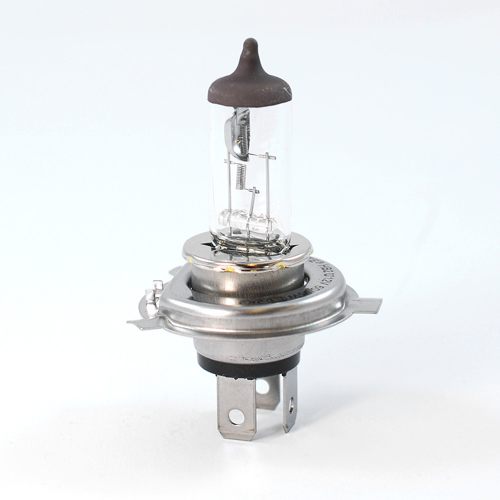

Sorry, bulb burned out on the way to town, and I got pulled over for "no headlight".
I'm at work, and manual is at home, anyone give me the specs on the high beam bulb so I can pick one up at lunch?
Thank you.
  • Posts: 15187
Re: V7 High beam bulb. Specs?
« Reply #1 on: June 04, 2018, 08:57:45 AM »
High and low are one bulb, which looks to be a regular H4 type.

What's the wattage on the stock bulb?
  • Posts: 15187
« Reply #5 on: June 04, 2018, 10:24:43 AM »
Likely 60/55.
Offline TimmyTheHog
  • Posts: 935
« Reply #6 on: June 04, 2018, 02:03:43 PM »
Likely 60/55.
yup
Low/high beam light (halogen) 12 V - 55 W / 60 W H4

My V7 Stone (2013) still has the first (Philips) H4 bulb working. After 5 years I thought about using a new one for security reasons. And a brighter light would be nice. So I ordered the bike - versions Night Breaker from Osram and Extreme Vision from Philips. Both low-beam parts lasted for about 20 min, then they blew! I then built in an old (unused) car - H4 from Osram and ordered the Philips Vision Moto. The Osram now works for weeks, the Philips has a rating of 500 h.
So, from my experience: stay away from those "superbulbs", use a vibration-resistent standard type instead.
« Last Edit: June 05, 2018, 05:47:11 AM by fossil »
