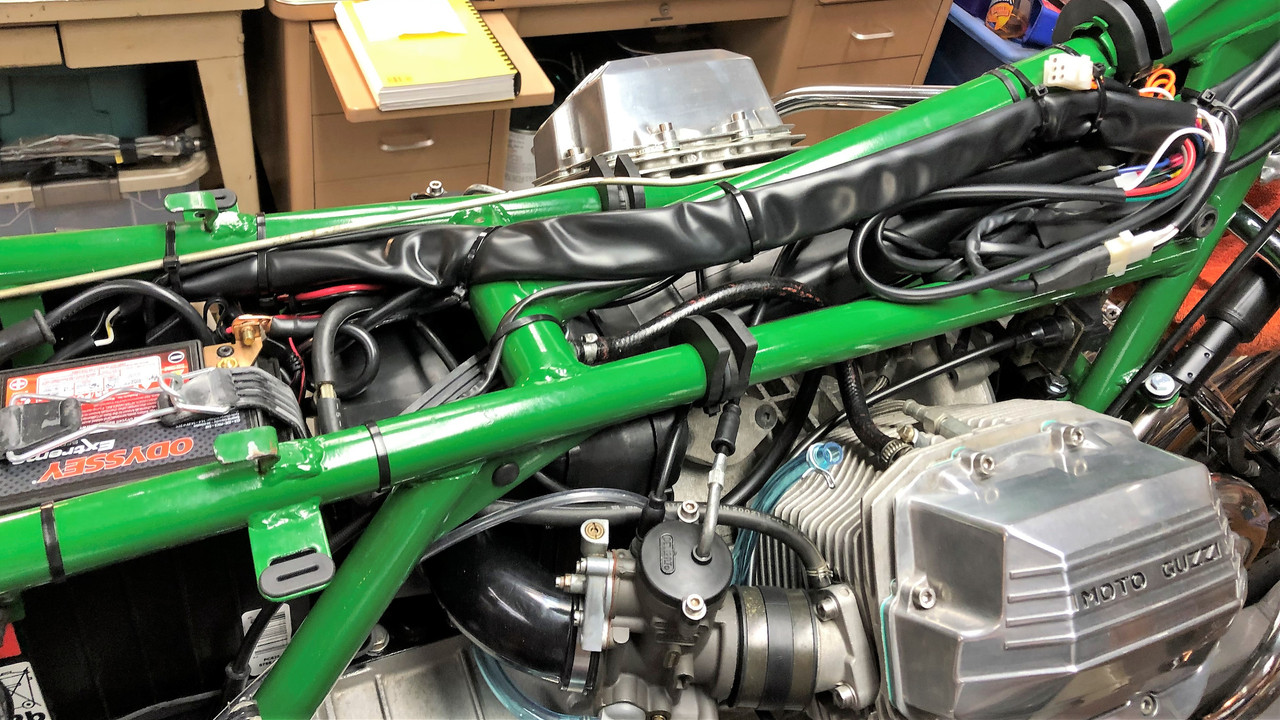

I just installed a wiring harness from Greg Bender on my 1000S. It was flawless, and functioned perfectly. I highly recommend. I will be using them on my V700, and Convert also.
Dave Swanson - Northern IL

Old Jock
Posts: 2655
Re: 850T Electrics 1975
Reply #11 on:
August 25, 2019, 10:26:16 AM »
Stunning Dave simply stunning
