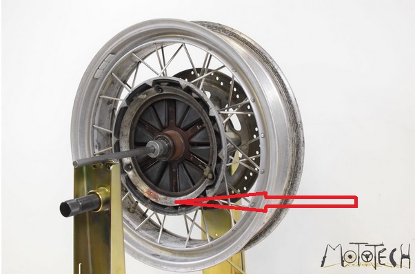

Online pehayes
  • Posts: 4806
    • Falcone Touring
Re: Recall for 98EV
« Reply #4 on: December 02, 2019, 06:52:06 PM »
Took awhile in searching, but I finally found and clipped an Internet image for the infamous 'spoke ring'.  Red arrow points to a light-colored ring in the interior of the rear wheel hub.  About 10" in diameter and 1" across.  Thin sheet metal.  Ring is held in place by two Phillips machine screws at 8:00 o'clock and 12:00 o'clock positions and a third hex head bolt at the 4:00 o'clock position.  The  hex  head bolt also serves to anchor the "Z" tab which secures the large 'split ring' that holds the cush plate in position.  NOTE:  The cush plate is NOT in place on this wheel image.  This spoke ring was NOT included on the original wheel.  As a result of the recall, every 98EV in the USA should have received a new wheel including the ring.  Twenty years on, I doubt there is any way to force Guzzi to come up with the parts.  Even the government has to allow for 'closure' at some point.
So, what is the recall status of your rear wheel????
