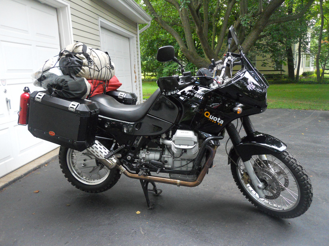

Hi Everyone, I am not new to Moto Guzzi by any means but it has been a while. In the early 80s I worked for a Triumph, Norton & BMW dealer as a mechanic. We picked up the Moto Guzzi dealership when Cal passed away. I have a lot of seat time on a shop Convert. We couldn't sell it so I rode it to keep the battery up. I have uncrated and ridden brand new Lemans MKIIIs (wonderful) and built a Cafe T3. But that was years ago. I got the opportunity to buy a black 2000 Moto Guzzi Quota. I wanted one when they were new and, true to form, I can have any bike I want but I have to wait 20 years.
So far I have only put a few hundred miles on her but I am really liking the ride. She is a tall girl but I am 6'-1" so it's good. I am mostly a sport bike guy but my knees and my hips are keeping me from fully enjoying that experience like I used to.  Plus I need to slow down a bit. I need a bike that feels right at a little slower pace and has a more upright riding position. The Quota seems Perfect.
My Quota has an updated rear wheel "Excel brand" and the tires are good Michelins. It has an Corbin seat and a broken trip mileage rest.  It has the cracked exhaust at the front right crossover and there in lies my question: how critical is it that I get this fixed. From what I have read from lurking here, the cracks will just show up again. I was just wondering if this will effect the already problematic fueling?
At last check I was getting 33mpg. I think the bike will benefit from an improved EFI map but I am still in the dark on how to do that. (I am still reading the material.) I did locate the port so I know it can be done. I just wanted to say that it is great to be back on a Guzzi even if my back can't take a LeMans!
image upload
2001 Moto Guzzi Quota (Black)
1974 Norton Commando
1966 Triumph T100

The fuel map is most likely not your fueling issue. There is plastic sensor holder that is advised you replaced with a brass one (sensor holder brass (#30163301) at MG Cycles)to get a better read on the actual temp.
My Quota would get 30's MPG then the next tank would be in the 50's MPG. This would be on a trip riding tank to tank on same road. I would have tried the brass sensor holder but I sold the bike because of not being able to buffeting and wind noise under control.
The stock where were also recalled for cracking at the spoke nipples. Hopefully the wheels have been replaced. Also the exhaust collector was know for cracking so hopefully that too has already been addressed.
Fundamentally they are great bikes. Comfortable and enough power w/ a decent suspension. They are like Converts though being a oddity within an obscure brand. KInd of like the fringe of the fringe.
Good luck and hope you enjoy many 10's of 1000's of miles.

The first thing I am going to do is a fluid change. This is the strange part, the previous owner gave me two oil filters. I asked "are the filters still in the pan like the old days?" "No, that's weird" he said.  My guess is he never changed the filter. I have no idea how many miles he put on the bike but I am interested to see what the bottom of the pan looks like.
As for wind buffeting, my Quota has a little wind screen extension that seems to deflect the blast. I don't notice any more wind that I do on my Honda VFR.
I'll check the bras fitting and let you know! The mileage doesn't really hang me up. I usually just fill up and don't stress about mileage but I would like the bike to run right for it's own sake. I am not going to mess with it too much until I put some more miles on her.
I know that a cracked exhaust, one that has a history of cracks, is usually stressed in some way. The designer in me wants to isolate and fix it. The lazy jerk in me wants to ride until it falls off.
By the way, the riding position is brilliant.

The fueling gets better when it is thoroughly warmed up but it still has a problem coming alive when the throttle is whacked open. You have to ease the throttle on but it was stubble a bit under a heavy hand.
I figure the Quota is not going to be a collector's bike so I am not going to worry too much about show quality finishes. (Like I ever would!) It looks pretty good right now. I will probably pull the pipes and get them welded up. I might even have a brace made for that corner to add some rigidity. It probably needs a flex coupling of some kind.

I looked over my pipes and they seem to match the Mistral header and collector after market offering. There is no provision for an exhaust sensor just two plain crossover pipes and one muffler.

Exhaust canister is from mistral, cant see the rear crossover. I have the same set up with the mistral headpipes. I'm on my second Quota.
I opened my airbox and had the ECU done. The bike is a hoot.

Make sure the Voltage regulator is well grounded, I suggest a #12 from the case to a timing cover screw.
The diagram shows a wire all the way back to the battery but its a bit wimpy, through the engine to the main ground is much better.
http://www.thisoldtractor.com/guzzi007/schematics/2000_Quota_1100_ES.gif
The Voltage regulator senses the Voltage down stream of the Headlight relay which also supplies the Tacho so be aware if the tach quits you probably don't have any charging.
I like the way they power up the start relay on this bike, direct through a fuse like it should be. :thumb:

Great bike, I had two. They have few items to attend to, other than that its a great mileage eater.
Kind of like Kawasaki KLR, does nothing well, but it will get you there.
Few items to pay attention to:
- Change to manual petcocks
- Observe the rims, they may start cracking
- Buffeting can be improved, but not eliminated. Side wings from Gustaffson Plastics will help a lot.
- 21" front wheel is not a great idea for street, but mine loved the gravel and mud.
- There is a wide version of the seat and a narrow one. Try to find the wider one.
- If you can find Papa Sloan two to one exhaust, get it.
- Regulator can give you issues, above post already stated that.
- Headlight suck. Swap it to Yamaha?

I really appreciate all the feedback. I did the engine, oil and filter plus I changed the transmission and rear-end oil as well. I wanted a bench mark for when the oil was changed. The inside of the pan looked great even though the oil was a bit dark. The transmission oil was really clean and the rear-end was dirty but that's to be expected. A close examination shows that the bike was loved in the past. It does have an aftermarket stainless exhaust (cracked at the left front crossover junction). The rear wheel is an Excel. I did add a fused extension for my Gerbings jacket liner but I have not needed it yet. (This is Texas after all.) The ground wire has already been added from my R/R to the engine so someone knew what they were about. It does still have the electric petcocks.
I have a little more seat time now and I do have a couple of questions. 1) I noticed that a cross wind knocks me about pretty good. Is this the "turbulence" everyone is talking about? 2) The rear shock seems really harsh. I believe it has some kind of aftermarket shock. There is a anodized knurled collar that turns and I have no idea what it does and there is some load adjustment further up (I believe.) Suspensions are not my strong suit and I usually ride them as they come but this is different. The front has a squishy dirt bike kind of feel (smooths out the bumps) but the back is like a board and just jars the disks in my spine! Any thoughts?
By the way, I love the riding position. Even though the north wind was pushing me around the wide bars gave me lots of control. I also love being able to stand on the pegs. This works to smooth out the bumps.

OK, I got some pictures of the shock, top and bottom. It looks stock. The spring preload looks like it is cranked to the max. Please tell me what you think.

   Stock shock, I replaced just the spring with a HyperPro #1127 on mine. Works great.

Oh man, that's a lot of preload!  And seems to have been done by a gorilla with a punch and mallet.   :grin:
In general, most info says preload should be 1/3 of your travel, some places say 1/4.  The Quota 1100 has 200mm of rear wheel travel, so 67mm sag is 1/3 and 50mm sag is 1/4  .  Can't remember where I set mine.
Not sure if you are super knowledgeable about this stuff, or never done it before ... so not sure if you are looking for tips/info ... will type a bit anyway.  :grin:
I get a helper as it is pretty awkward to do it solo.
Get the Q on the center stand, pick a point on the swingarm and frame to make measurements, you want a straight up/down angle vs. a laid over angle of measurement.  Take that first measurement.
