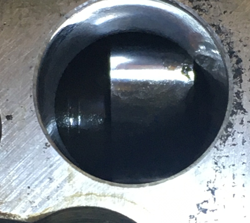

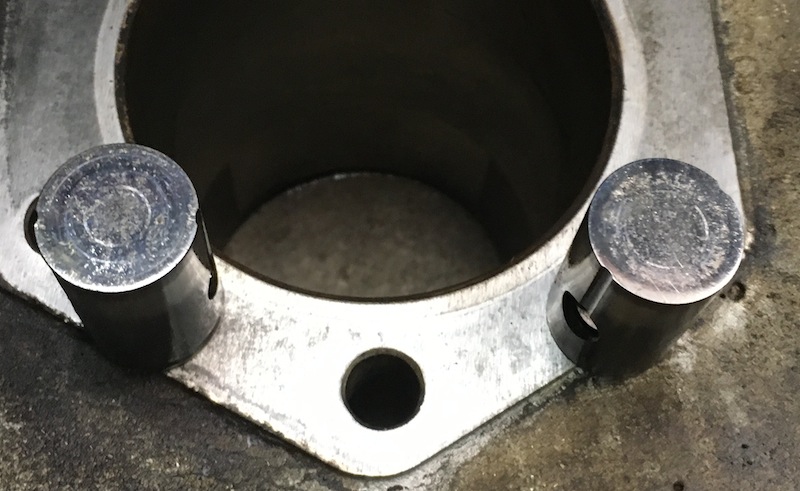

I'm rebuilding the top end of my Le Mans 1000 and need to replace the cam followers. The old one are pitted and at the end of their life.
Does anyone have any experience with aftermarket followers? I've heard good reports on the ones from Stucci but not so good reports on the Stein Dinse followers. I'll spend the extra for genuine ones if need be.
And yes the cam needs to come out too, it's pitted.
Old Guzzis sure can be expensive  :grin:

Are the follower surfaces concave or convex? How many miles on the engine?

wow, that bore looks damaged as well, maybe something else happened, and the mating surface on your block looks porous, I've never sen that before. I have seen pitted followers but not a cam.

Cam can be reground and lifters refaced by Delta Camshaft in Tacoma, WA.
