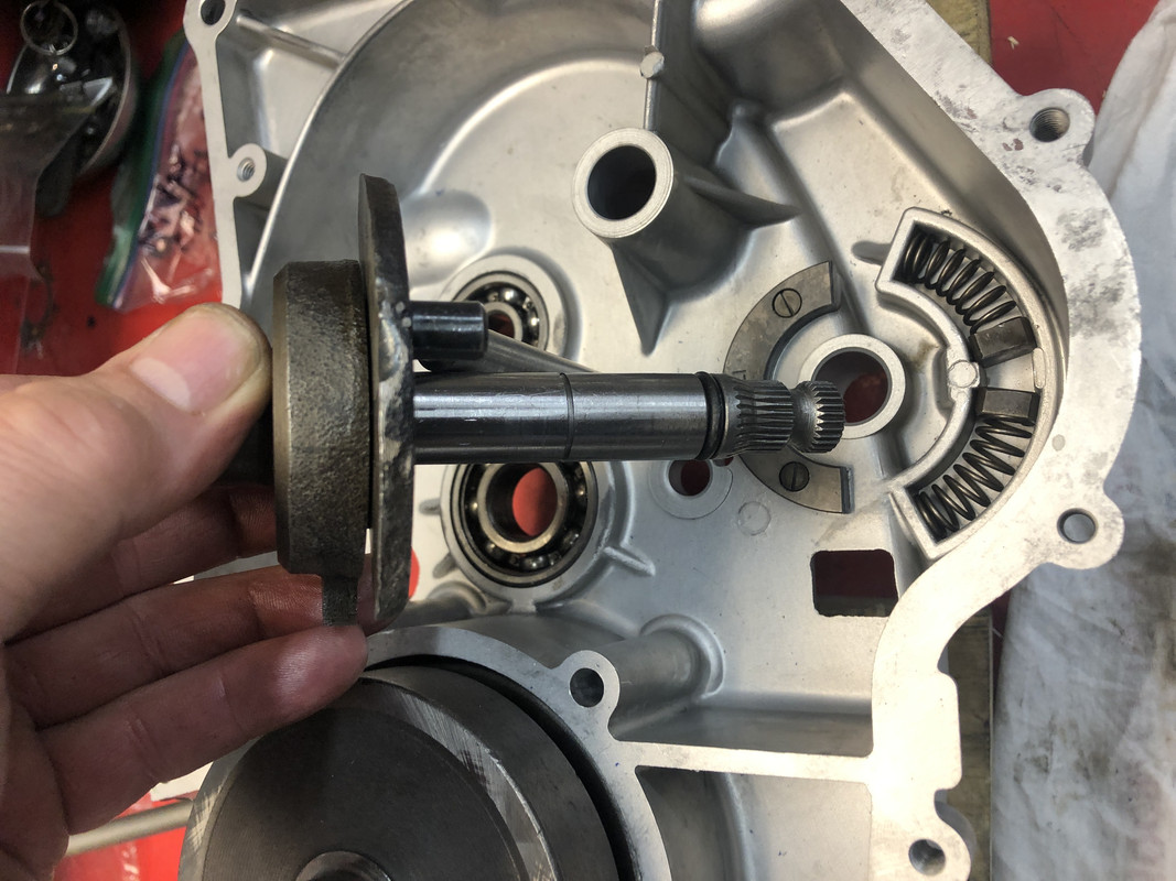

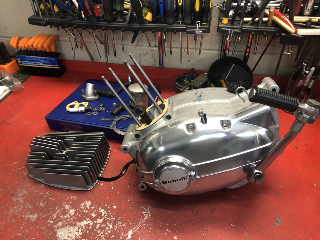

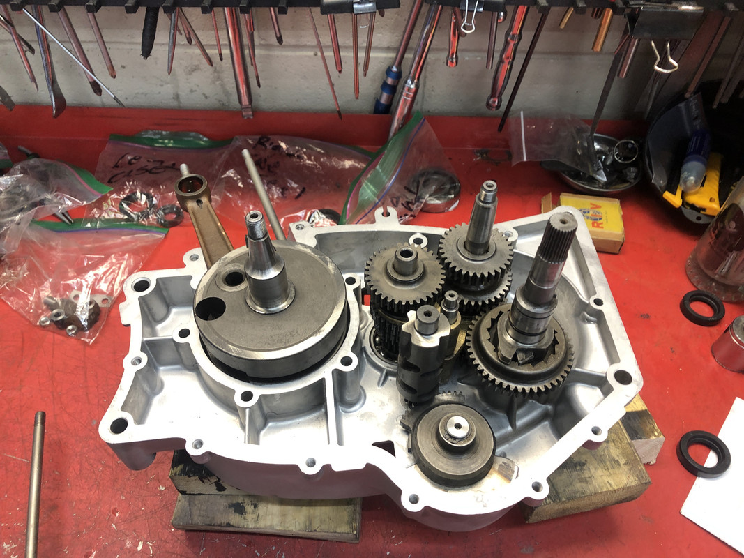

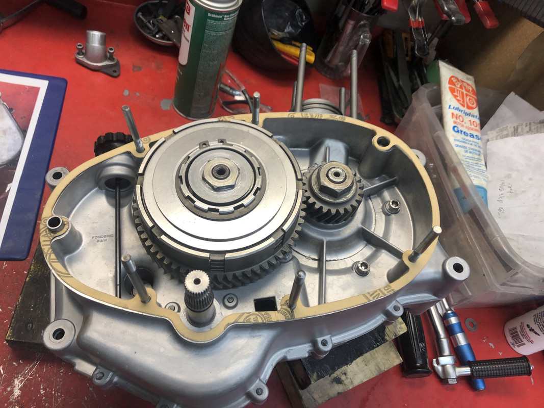

I used HondaBond after thoroughly cleaning the joint surface. trying to trace a paper gasket given the size and complexity of the surface to seal was not something I wanted to attempt
Bottom end reassembled, waiting for the cylinder overbore to be done
Italians sure know how to design a pretty engine
I did make a new cylinder base gasket though from stock sheet I have, easy enough to trace and punch out a simple gasket like that one.
« Last Edit: April 08, 2020, 07:46:41 PM by Canuck750 »

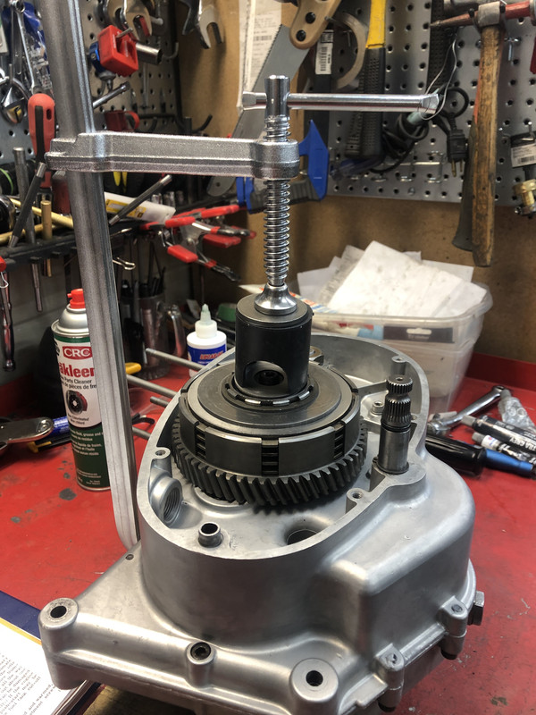

Yep the 'beauty' of a simple single two stroke like this is it doesn't even have an injection system to the carb manifold like on a Yamaha of similar vintage, good old fashioned pre-mix of fuel and oil, a bit of a PITA but dead simple. One thing I do like about the transmission is the gear selector system, it uses a pair of springs to center and return the shift mechanism, no heavy spring to break.
The clutch uses a single spring like on the Aermacchi 250 / 350, very simple but a wee bit of a challenge to compress while refitting the holding nut
I always find it interesting to see how different designers tackled the same problem.
