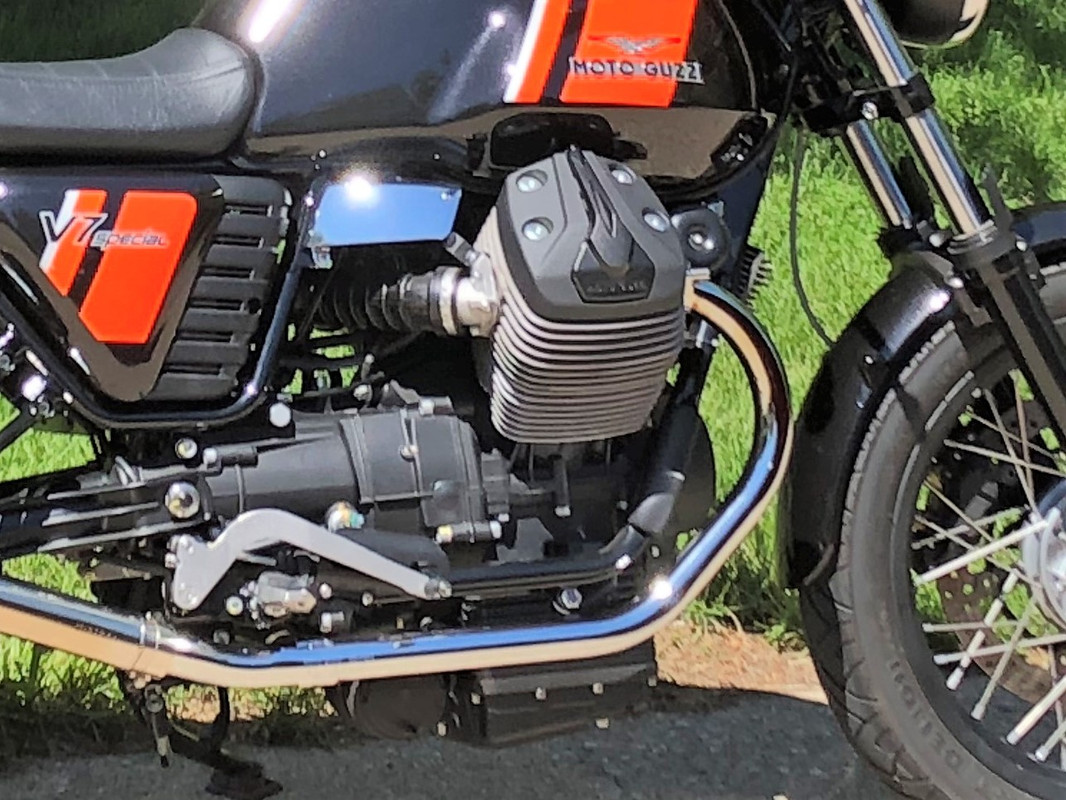

Are the bolts for the V7 the same as the V7II?  I imagine they must be different because they are quite specific with their description, V7II
Offline alanp
  • Posts: 1763
Re: V7II Valve Cover bolts
« Reply #4 on: March 17, 2020, 04:53:30 PM »
Dave,
I do not know FOR SURE, but my valve covers and bolts on the V7II look identical to yours, and it would only stand to reason that MG would not change something like that and still have it look identical.
As an aside, did you take that picture at the dealer before bringing the bike home, or do you have some magic elixer that keeps your header pipes looking like that?   I don't think mine looked that good for more than 5 miles before turning blue and mottled.
« Last Edit: March 17, 2020, 04:56:37 PM by alanp »
Niwot, Colorado
'16 V7II Stone - Black
Previous Guzzis
  • Posts: 4773
« Reply #5 on: March 17, 2020, 05:23:37 PM »
Dave,
I have always been kind of a fiend regarding my chrome pipes going back to 1974 when I bought a CB750K.  If you keep up with them it is quite easy to maintain them.  I use Blue Job on them when they start getting a bit discolored and then clean them thoroughly with alcohol before starting.    A Beetle map cuts down on the discoloration a bit also.
