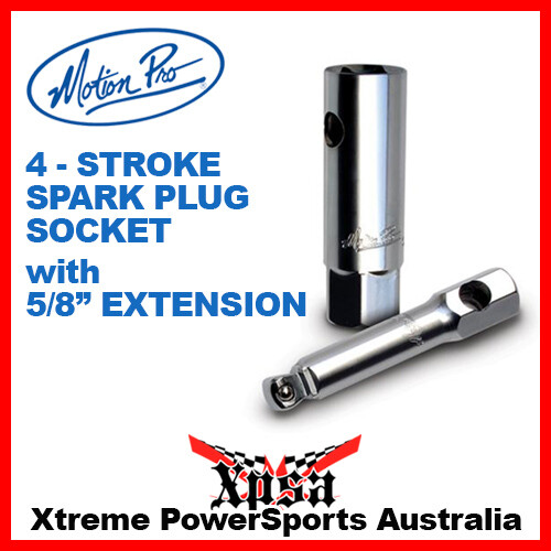

I found this one fitted my Breva 1100.  Often available from dirt-bike dealers.

That is the socket and extension I bought.
The inner plug change out went well. I waited too long to change them. I think 30,000 miles. 24,000 is the longest you want to go. I noticed it running rough at 30,000 miles. The inner plugs made it run well.
The air filter lasts a long time too, maybe 12000 miles, maybe more.
