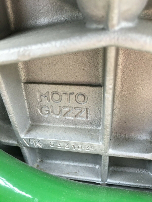

I don't get why you'd re-stamp like that.
Pure butchery!
  • Posts: 14799
Re: V7 Sport E-bay -
« Reply #2 on: September 13, 2020, 08:26:59 AM »
Replaced the engine (case) and wanted the numbers to still match?

Can’t say that guy was trying to mislead anyone.
Agree, he does provide a clear picture of an obvious amateur numbers job, but no explanation is provided.

Does anyone else see the Faint original VE underneath the hackery ? If that is what it reads, then that would be a lemans engine which could be a selling point for a daily driver.  I hope they didn't fill the frame numbers with powder coat, if that is how they colored the frame in green.

« Reply #9 on: September 13, 2020, 11:22:37 AM »
    It looked like VF to me ,but either way it would still be a Le Mans I,II or III and as you say, a selling point not an amateur cover stamp job.
