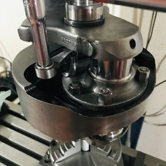

Like the rods and pistons, even NOS AE pistons out of the box need some prep just like the rods.
I did drop around $4.5k on a new cylinder head along with KW valve train parts and Amal Premiers, both of those needed work out of the box so little has changed.

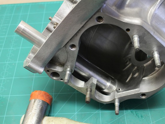

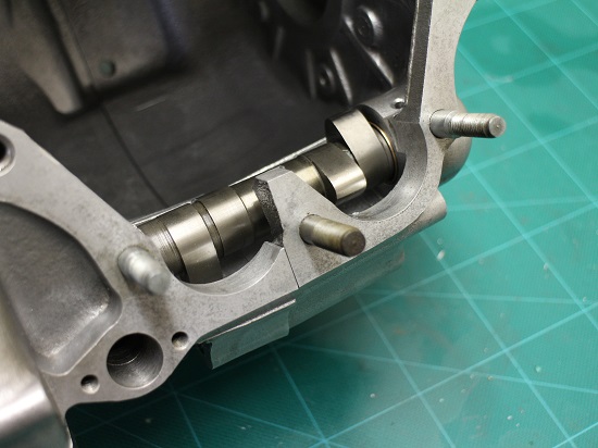

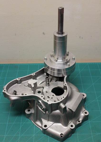

One of the problems is, who can work on your Norton ?
Lets say some previous owner did whatever it took to corrugate both the camshaft journal and bush (lack of oil ?) to the point both need replacement
Now what ?
Take it to some shop that does not exist or do it yourself having no choice.
One two piece 7/8" line reamer to do both bushes..
One free spinning replacement camshaft with the correct running clearance along with modified oil feeds.
Its not for everyone but you get to learn new things as an elderly person.

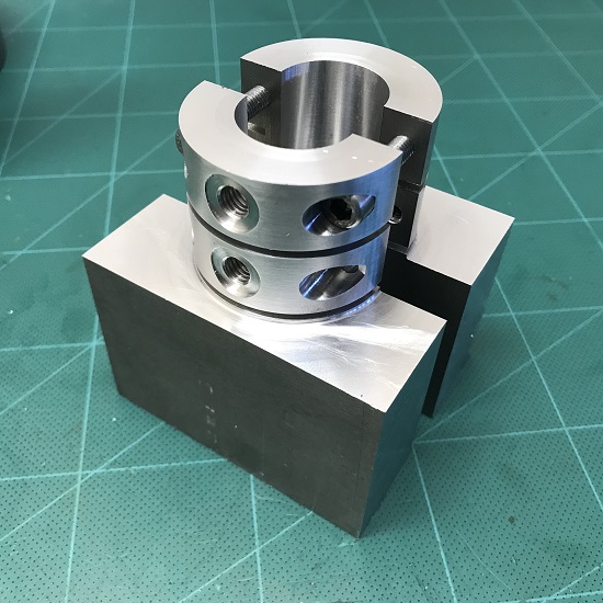

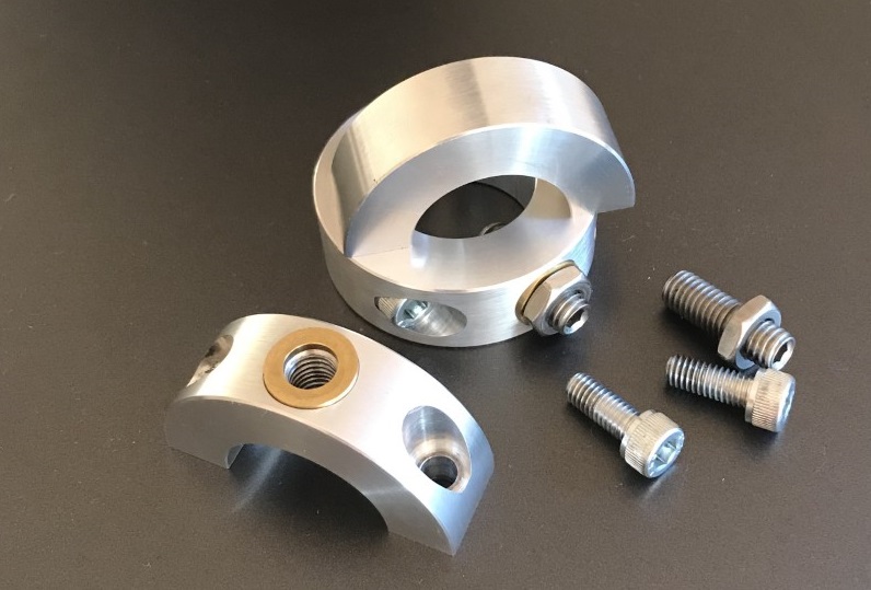

Want to stabilise the rear swingarm spindle, just machine some cradle clamps to push on the spindle itself.

More Norton.
Now what ?
Having both a prepped Norton Commando and a Moto Guzzi Eldorado, priceless.
Love the cradle clamps!!!   :bow:

 Nice photos of the Norton engine above.
 I have little faith in  60 year old aluminum connecting rods with unknown history..My Triumph race turds have aftermarket seel or alloy rods.
  The current 61 BSA  A10 has R&R aluminum rods....$450 ain't cheap but a lot less than a broken rod sawing the cases in half..
