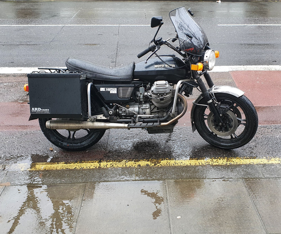

My G5.
It depends what you want.
My bike is fast and reliable. Faster than a Mk1 LM
Ported heads to take 36mm carbs + Le Mans exhaust system(including front crossover)+ lighter fly wheel make a massive difference to this engine. Its surprising how much difference the exhaust system makes combined with 36mm carbs. Will do 120mph and accelerate hard at 80mph in top. Thrashed for the last 10000 miles with no issues. At least dump the heavy fly wheel which serves no purpose. The LM flywheel is still plenty heavy enough but I have an 1100 sport flywheel. I also have bell mouths and a fast road cam. I would leave the valves sizes alone - expensive and small valves breath well with the other mods. I prefer the broader spread of power to the higher compression LM engine. Mount the calipers on the front. Really improves the steering -  they are heavy and the position makes a noticeable difference whatever others might say about this.
Other special bits - Marzocchi 38mm forks, Brembo organic race pads, 11mm front master cylinder for improved power and feel, Agostini rearsets, Borranis and a Harley side stand on the Cali style mount.
The bike will hold its own with modern bikes as it pulls hard coming out of corners and brakes well. Also super comfy with clip-ons mounted above the top yoke.

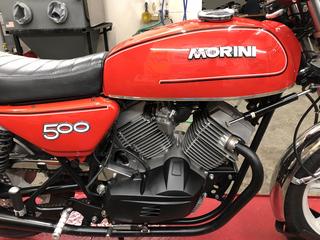

Here is a photo of mine. All stock per 81 specs (2nd gen) other than the color and pipes.
I like the gloss dark paint, it brings out the line of the tank meeting and flowing with the seat line, thick stripes take away the continuity of the line, at most a thin single or double pinstripe picking up the line on the tank.
an example of the seat following the crest of the tank and a thin pinstripe accentuating the line on the tank, this is a stock Moto Morini 500 paint job, the guzzi seat / tank on the G5 has the same flow
The Moto Morini got it right Canuck. I like the MG thick and thin bottom tank stripes and the thin top stripe.  I’m going to try to get the most lustrous black I can.
