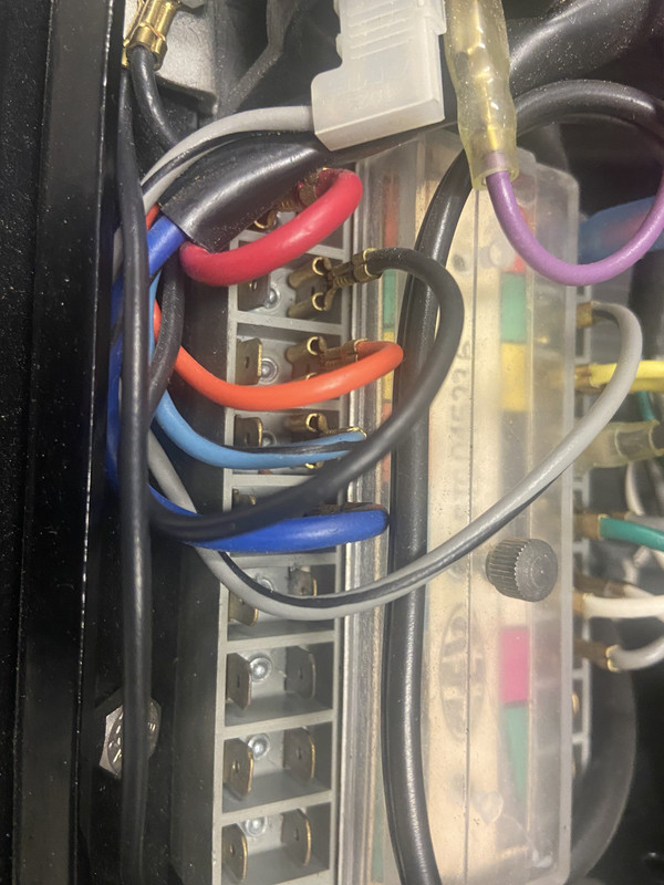

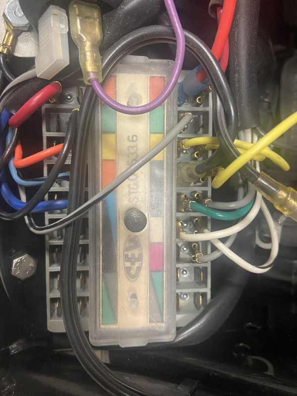

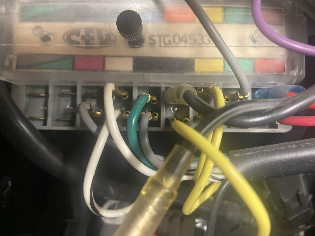

Hi there,
I'm new here, so please forgive me starting a new thread if it has already been covered in detail elsewhere (although that seems unlikely...)
I've got a '73 V7 Sport that I'm trying to tidy up a bit, but I aim to keep it in "used" condition and ride regularly.
One of the few areas that looks a bit sore is where a previous owner has removed the original grey "CEV" fuse-box and fitted some gaudy new item with blade fuses. I've got the original and I'm trying to rebuild it and reinstall it, without setting the electrical reliability of the bike back 40 years.
Does anyone have any photos of their V7 Sport fusebox showing the layout of the wiring, the fuses and the famous "courtesy light"? I'd be most grateful if you could share them.
Best regards
S

Thanks very much for all your wise words. I've attached some pictures below of what I'm trying to correct and where I've got to with tidying up the original part. 2 days sat in vinegar seems to have got the terminals looking pretty good again but I note the comments about corrosion between the faces so I'll check continuity is good. I also note that a couple of the photos show all the rivets being replaced; I have some brass tube rivets on order but maybe pop rivets are going to be a bit more robust. I also noted that one of the fuseboxes has had the same melt-down as mine....
The courtesy light looks like nothing else I've ever seen so I may have to give up on the idea of replacing that, unless anyone knows of a source?
I will get a photo uploaded when (if) I ever get this back together and working...
Best regards, S
