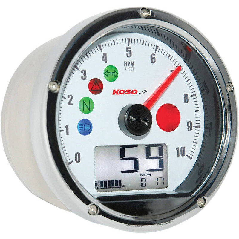

I bought the big Koso Multi-function analog round one with integrated idiot lights (BA035k00 TNT-01), but that was for the civilian/single gauge dash. It would need a small trim ring fabricated or 3-d printed, as it is about 4mm small for the opening...   But I sold it with my v65 cafe project, otherwise I would post some pics
Also Canuck, If you want a single-gauge dash to make this conversion, I have one in great condition I can send you for shipping. Your contributions to to forum are legendary... Just shoot me a PM, I can send pics for your consideration

is this the gauge you have used?
https://fortnine.ca/en/koso-tnt-01-multi-function-meter?utm_id=14215143271&utm_campaign=pla-1433727171082&utm_source=google&utm_medium=paid&utm_content=124431327254&gclid=Cj0KCQjwuaiXBhCCARIsAKZLt3mC0ElYdTiBBLZrV0NEl-LIE4g9OmzwsWvmPi_A-emkbkkEZoUL9yEaAsQEEALw_wcB#76=8830&615=22869
I like that the bezel appears to be removable and I could then make a larger diameter bezel out of aluminum to suit, plus a tach and speedo all in one!!

Yep, That's it! I had the black face. $199 on Amazon fyi
