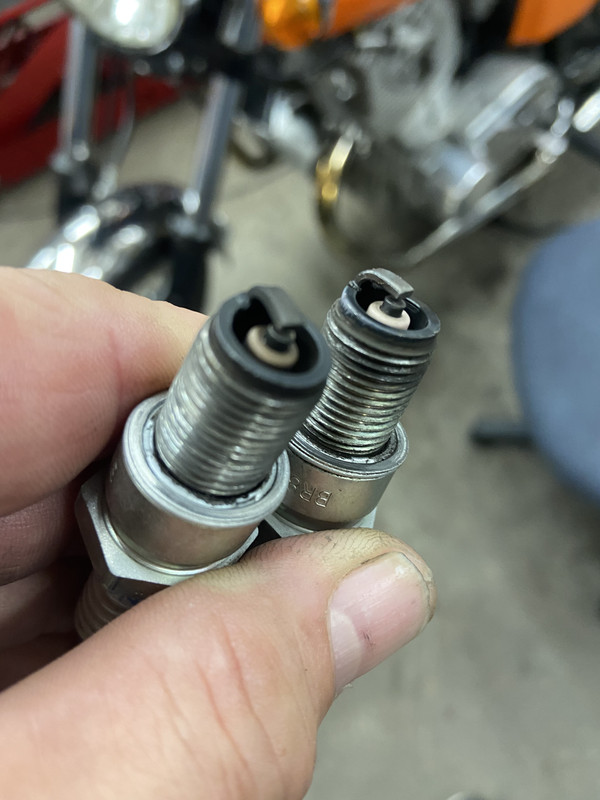

Pulled the plugs this evening, one side just a little bit leaner than the other but both show a lean burn to my eye.
I could swear it feels like the ignition is switching on and off but I am beginning to wonder if I have the bike running too lean on the idle circuit and once very warm on the start off its starving for fuel?

Wolfgang got back to me, he had installed new coils and high tension leads in the bike last year. He suspects a partial plugged pilot jet and he says Laverda like Champion N3C plugs better than NGK
I will check the keys this week and the carb boots as well.

I will give that a try, the pilot jets are spotless, I put in a pair of Champion N3C plugs as well

With the plug change to Champion N3C its better but once again it shows up after bike has had a good run down the highway and then has a few burps taking off the line again. Enriching the mixture screw a bit judging by the colours of the two stainless headers, and the plugs, failing any significant change I will raise the needles one notch.

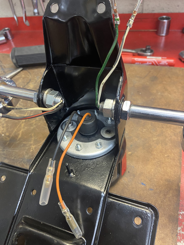

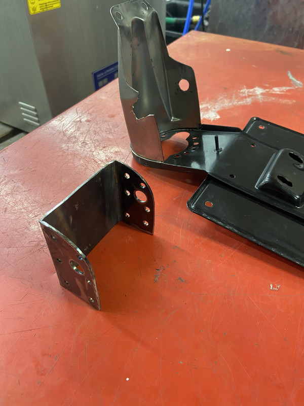

After my ride Thursday I noticed the rear signal lights were waging back back up and down, the Laverda shakes a 'bit', look what it did to the two year old rear plate and lamp bracket, both sides all split and deformed
a thick steel reinforcing plate should resolve that, thick washers spot welded to the exterior
