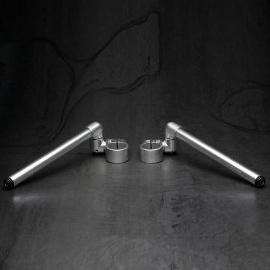

This might be what you want.  I have no affiliation with this place except that I bought a set of these (for my Sport1100i) from them.
https://revivalcycles.com/products/tommaselli-adjustable-clipon-bars
Be sure of the diameter of your fork tubes (35mm??).
Look in the Swap Meet:    https://wildguzzi.com/forum/index.php?topic=119608.0    for a picture of them on my Sporti.
They're really nicely made, and they moved the bars about an inch up and about 1.5 inches back in my case.

https://www.mgcycle.com/index.php?main_page=product_info&cPath=52&products_id=2451
You might consider these from MG Cycles. They'll work on your 35mm forks.

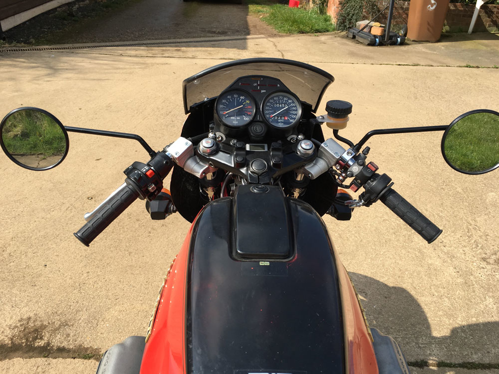

I fitted Tarozzi adjustable clip-ons to my LM2 and find them much better as I can both raise and alter the fore-aft angle. Also I like that they are longer so give more 'leverage' and a better (for me) riding position.
I think LM1 forks are a different diameter but I'm sure they make them for both.
Before;
After;
Of course, being infinitely adjustable they can be set at a higher angle if required but the above suits me.
« Last Edit: October 10, 2023, 05:33:28 AM by Dukedesmo »
