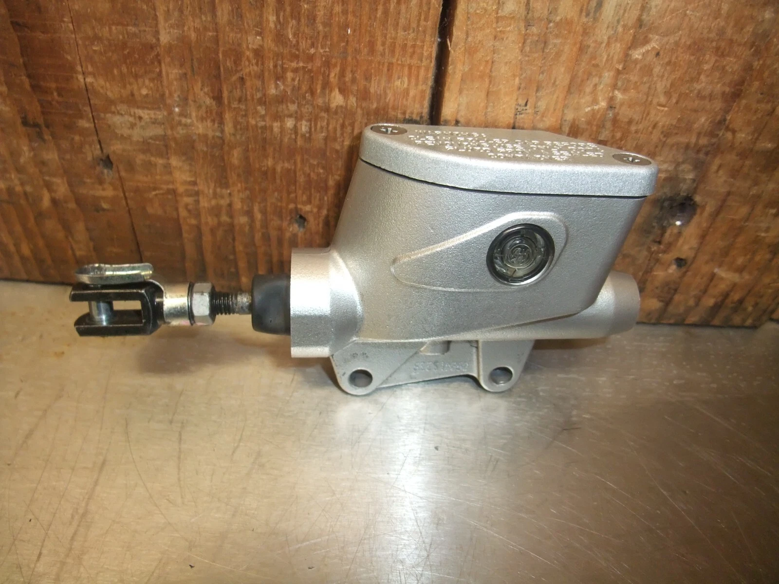

Here is where you adjust the brake pedal height on the V7 750 2015, and probably other years as well.
And here you see the adjuster for the V7 850, as well as the V9.

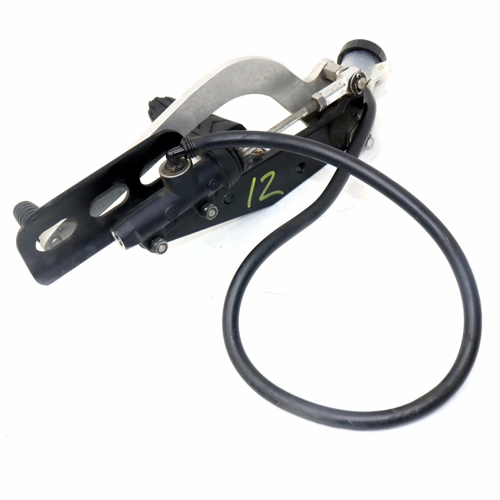

These? I think I might have to order me a set!
https://japan.webike.net/products/24875729.html#specification
