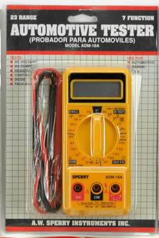

I have a nice, cheap Sperry meter, the ADM-18A, that directly measures up to 10 amps. It has been discontinued in the US, but seems to be for sale in El Salvador and Cambodia. Dale Electric Supply in the US has six of them now at $29.95:
https://www.dale-electric.com/products/browse/manufacturer/A_W_SPERRY/00193/sort:itemnumber

Nice soft wire, too good for a simple shunt, Nice meter

Will this work?
No, that belongs in a museum
I don't think it has an Amps range
