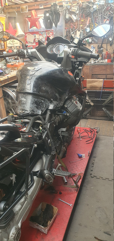

Popped the front wheel in so now it's off the engine stand and on the main stand. No longer attached to the scaffolding frame and down a notch on the bench height. Think today I'll get the throttle bodies on and start tying in the loose wiring and hoses.

Throttle bodies, starter and associated cables wiring and hoses back to where they were.

A few more steps further on, just wee jobs and starting to relocate some cabling and some plastic.

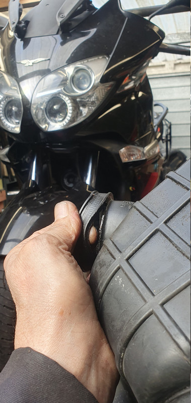

Anyway, threw in an extra cable this morning from alternator straight to the battery. Time for the airbox to go in and we're nearly ready to roll.
Well, I'll have to wait for my replacement inlet rubber to arrive from Stein in Germany.

Rubber arrived, as it has warmed up here in Norf London the rubbers were nice and soft so the airbox floated in nicely.
Tank on, 5 litres of fuel and after a few start attempts the fuel got through and we have action.

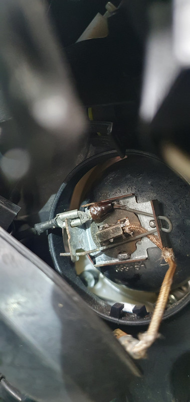

So I had to wait until the engine was running to check my lights.
Both dip earths and wires had signs of a previous owner.
Damn, it's a long way back into the fairing to do anything but repair the previous work.
There's not a lot of extra wire to play with.
In the top photo y'all will see the terminal is missing and has been replaced with a terminal/ earth on the bulb retaining clip.
It was quite a fiddly wee job but got there eventually.
