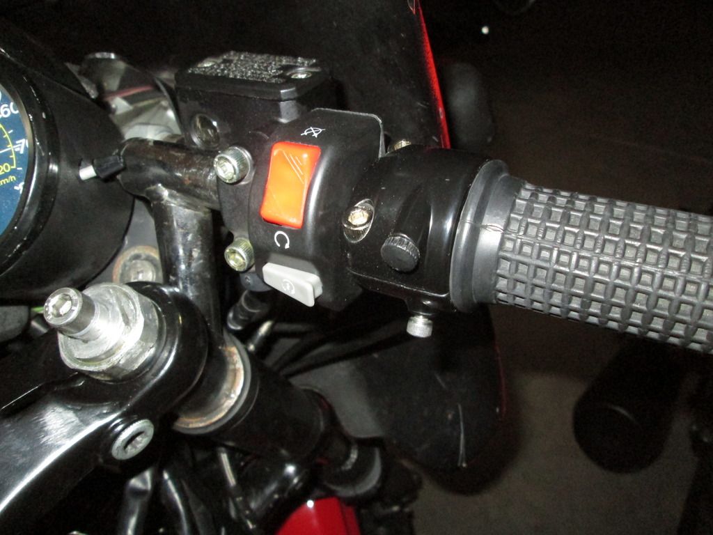

Original one-piece switch and throttle:

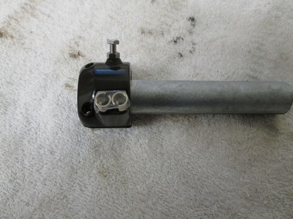

I could find, nice, expensive Italian thottles but they are all over 100 clams so found an Emgo 44-29474B that was cheap (Guzzi content) and looked OK, but has some issues (see below):

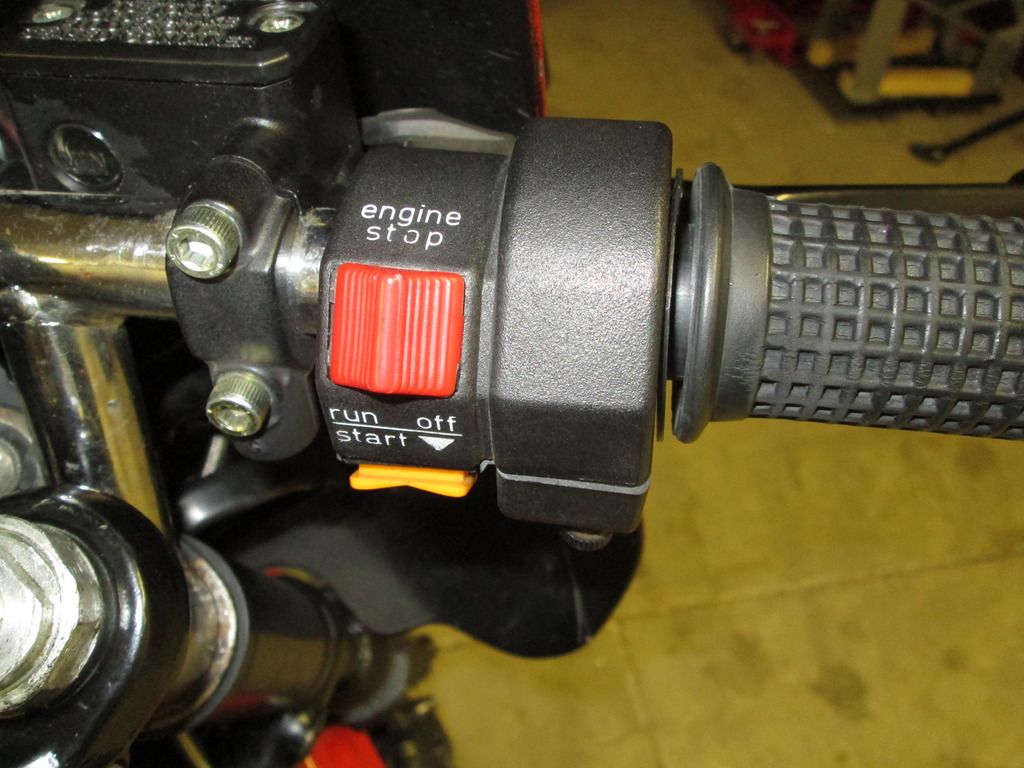

Simplest was installing the new switch.  Test fit switch and twist grip:

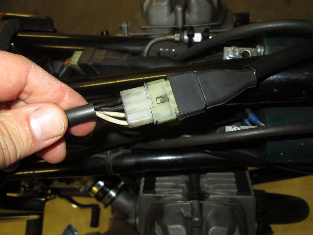

Pull 4 pin Molex under tank:

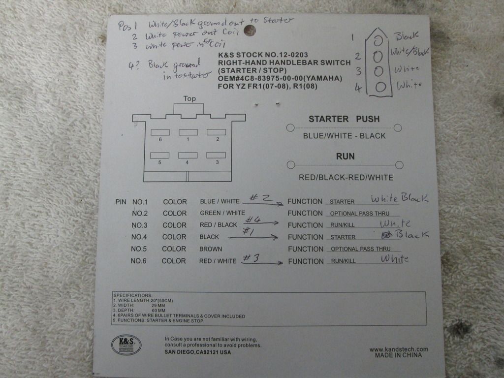

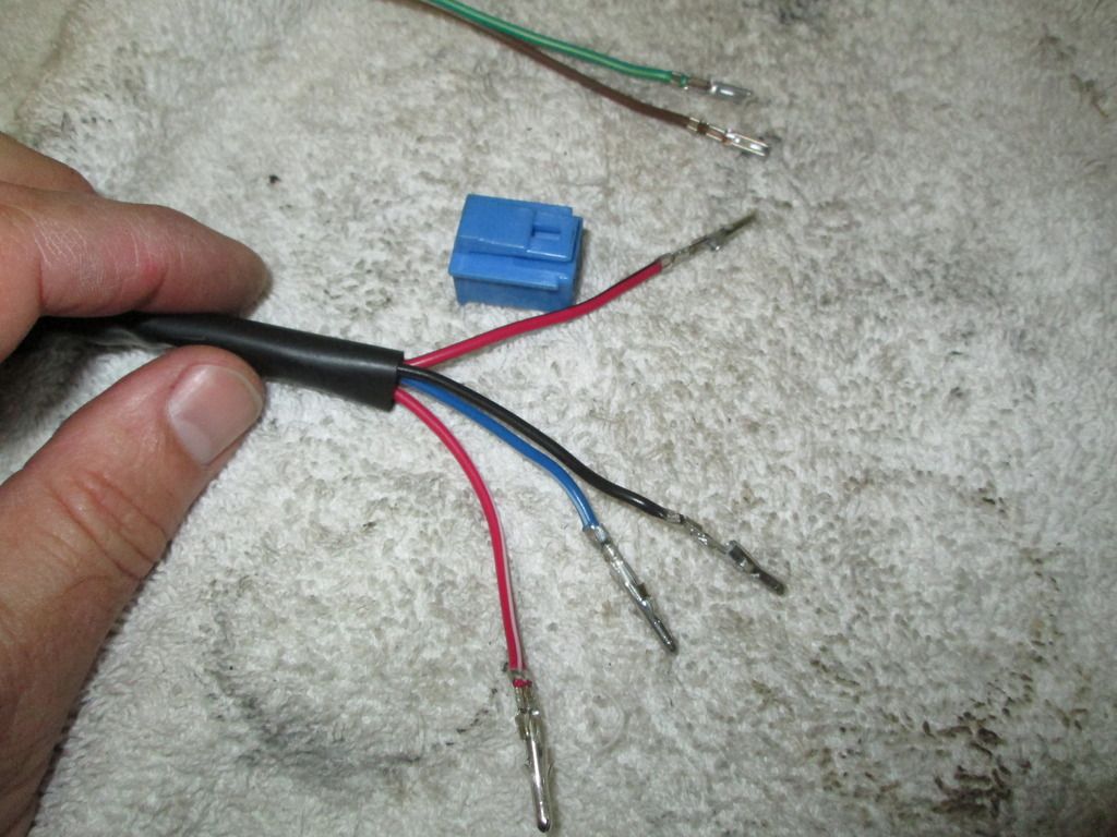

Cut off the plug ends of the K&S switch and soldered on new Molex connectors (available at a well-stock hardware store) so that the new K&S switch now has the correct connector.
The order of the wires is marked:

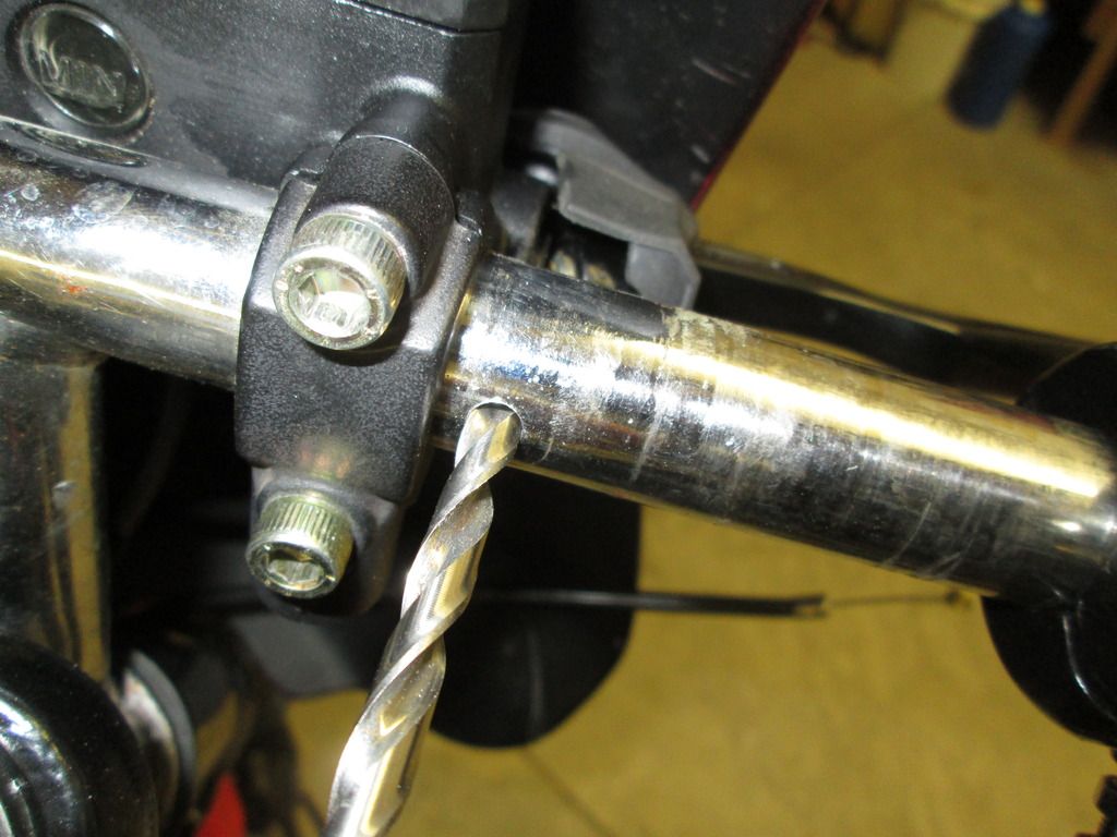

Drill hole for locating pin:
Starter and coil connections can be checked just by plugging in the new switch and hitting the starter - its grounded through the wiring.

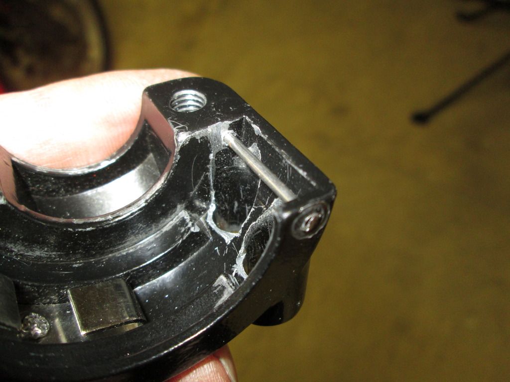

The PITA was the twist grip.  It has a throttle stop for wide-open, but none for closed throttle.  Carb springs will return the throttle, but the twist grip will turn another 1/4 turn past the point where the cables enter the twist grip.  This seemed likely to dislodge the cables.  The fix was to drill a 1/16" hole through the lower section of the barrel and drive a small nail in to make a stop.

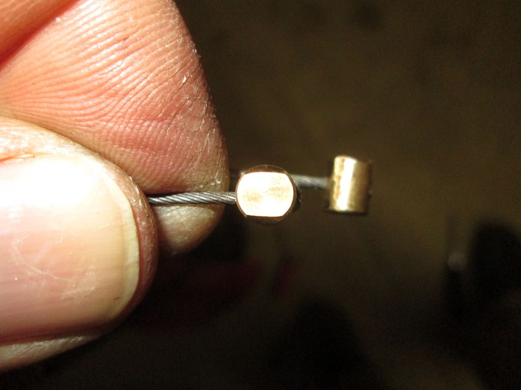

The other issue was that the cable ends are slightly too big to fit through the ferrules.  A little filing on the edges took care of that.
The new twist grip and switch installed:
There are 2 things I don't like about the Emgo throttle: no closed throttle stop, and both the open throttle stop and the throttle friction adjuster screws stick out in such a way that they seem likely to tear flesh in the event of an "excursion". However, throttle cable balance is much better.  Throttle cables are firmly held in the Emgo twist grip (they are loosely located in the original) and throttle cable synchronizing easier and more consistent.  Consequently carb synchronization has been more precise.
