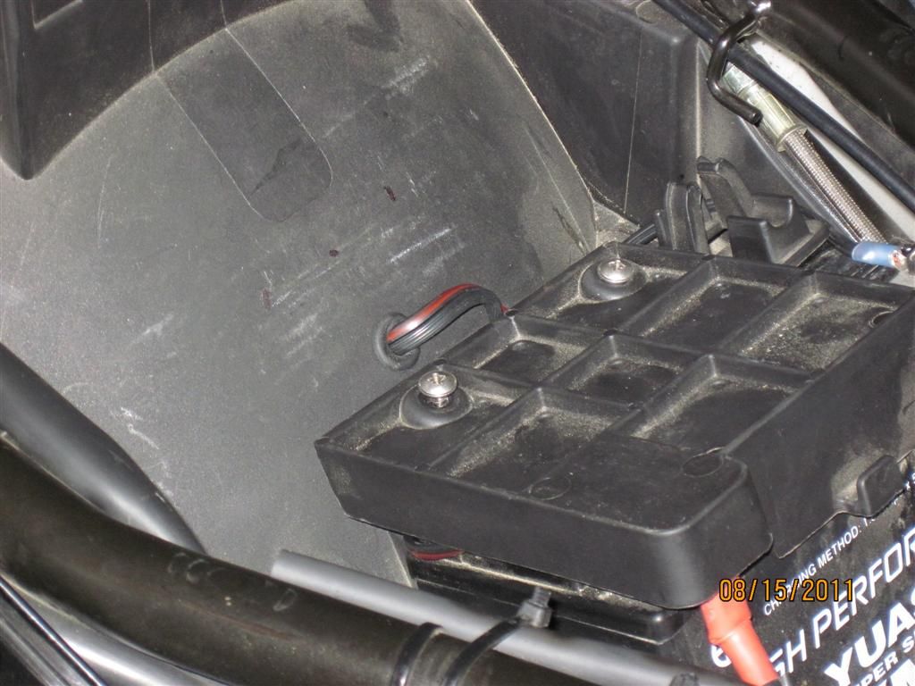

Quote from: guzzi ride on April 26, 2012, 05:34:08 PM
Here are some pics of my Norge with the powerlet plugs.
